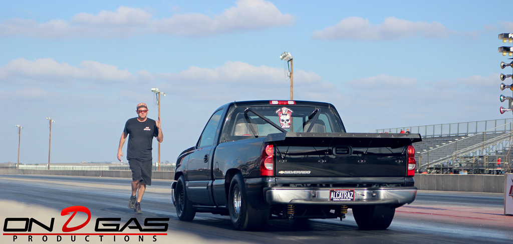

Not a chance. I'm actually under a contractual sponsorship agreement with the Alcatraz Federal Penitentiary. Part of that agreement states that the truck will always have a Procharger on it.
The warden likes making turbo guys cry. lol
