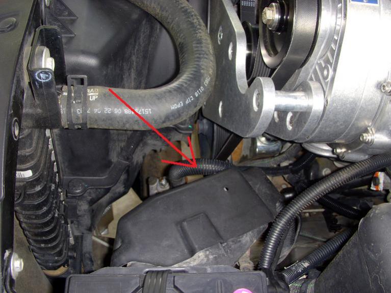

Just snapped a quick pic of the problem. Check it out and let me know what to do with this damn hose.

I dont have a procharger, but I did notice in the first link, post #4 pic #3. There is that same angle pic you took.

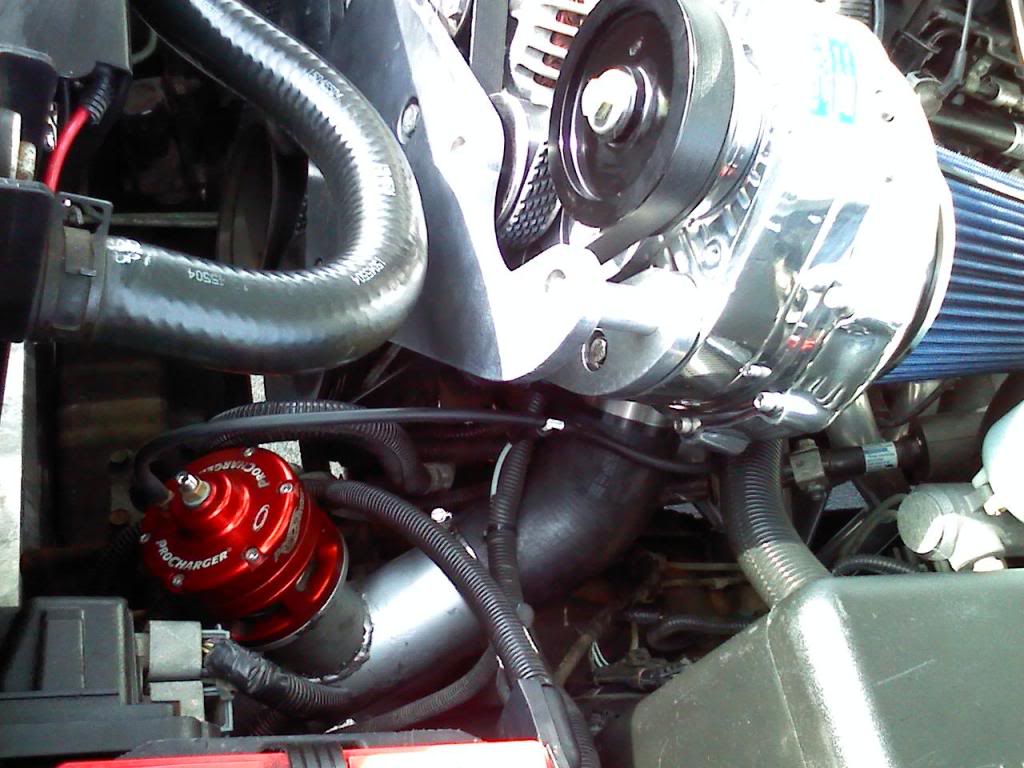

It looks like here he moved the ECU over. I don't have a procharger, but someone with one will post, it's just slow friday nights.

Old Jun 11, 2010 | 09:34 PM
sharpshooter's Avatar
Joined: Feb 2007
Posts: 1,539
From: Delaware
yeah man,dlt76028 is right

i don't have the race valve like that pic. But in the install manual there are multiple pics of the computer in stock location and plumbing running between pcm and belts. Is everyone else moving their pcm to make it work? Thanks.

Hey, that looks familiar! Yeah, just move the ecu.
