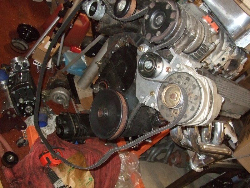

HAH! I don't want to **** Mike off right now, I'm going to need some stuff from him very soon. I've got a second Vortec 454 on the engine stand I'm using for mock-up. Mike just sent me one of the alternator relocation brackets they used on the no-longer-sold Vortec 454 kits. That's going to free up the entire passenger side for the compressor and induction! At this point I'm going to be using the same 200R compressor with the carb flange and likely the un-powdercoated version of that Eldelbrock elbow. I figure the bare-cast piece will be better since a 1.5" bypass tube has to be welded on.
I've got quite a mess going on in the garage right now myself.
http://bertok.us/pics/altbracket.jpg
