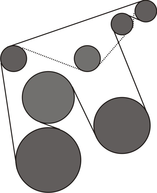

Is that sliding idler pulley what keeps that belt tensioned? I haven't seen an 8.1 kit in person but it looks like there's some re-routing of the belt involved with the kit and it sort of even looks like the alternator is running from the water pump?
If the pulley isn't keeping tension, I might have an idea for re-routing the sepentine belt for optimal wrap.
I meant to ask before, but are you running a Dayco Poly-Cog belt already?
Truck is using the stock tensioner. The tensioner on the whipple blower bracket is adjustable, but not spring loaded......you set it and tighten it down. That pulley is a 76mm Dayco and I was considering upgrading to a 90mm to get a little more wrap. The alternator runs off of a secondary belt driven from the water pump pulley. The 8.1L kit replaces the single belt pulley with a double belt one.

Okay, cool. Being adjustable might make this possible.
In this first diagram, you could consider routing the belt from the current path (dotted line) to the new path. My only concern with this is the angle that the stock belt tensioner is pulling on the belt at and if the reduction of angle would be too much for it to adequately absorb the slack.

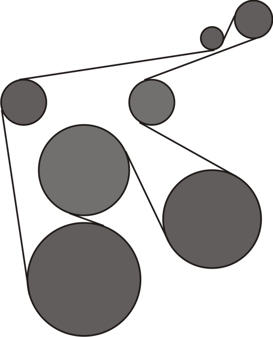

In this other diagram, if the Whipple idler pulley can be reduced to the smallest size available and slid to the passenger side, the belt might clear. I'm looking at a stock 8100 photo and your pictures to draw this, all of them were at weird angles so I can't tell if this would work or not in real life. You could probably use a piece of string between the pullies to find out.
I thought about routing the water pump as the last driven accessory but doing that would put it after the tensioner which could cause the belt to go slack if the clutch fan locks or the alternator is drawing current since it appears to be running from the water pump pulley on a seperate belt. That option was ruled out.
As far as total belt length for this... I have no idea.

Thats pretty cool James.....I actually like the second option better as it continues to utilize the stock idler where the first option does not. I would definately have to find a smaller whipple idler for the whipple bracket though. I will take a look at these options tomorrow and see which one would actually work out better and exactly how things lay out.
