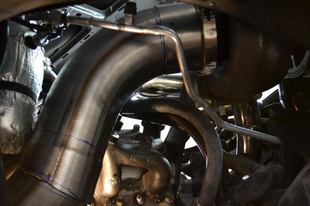

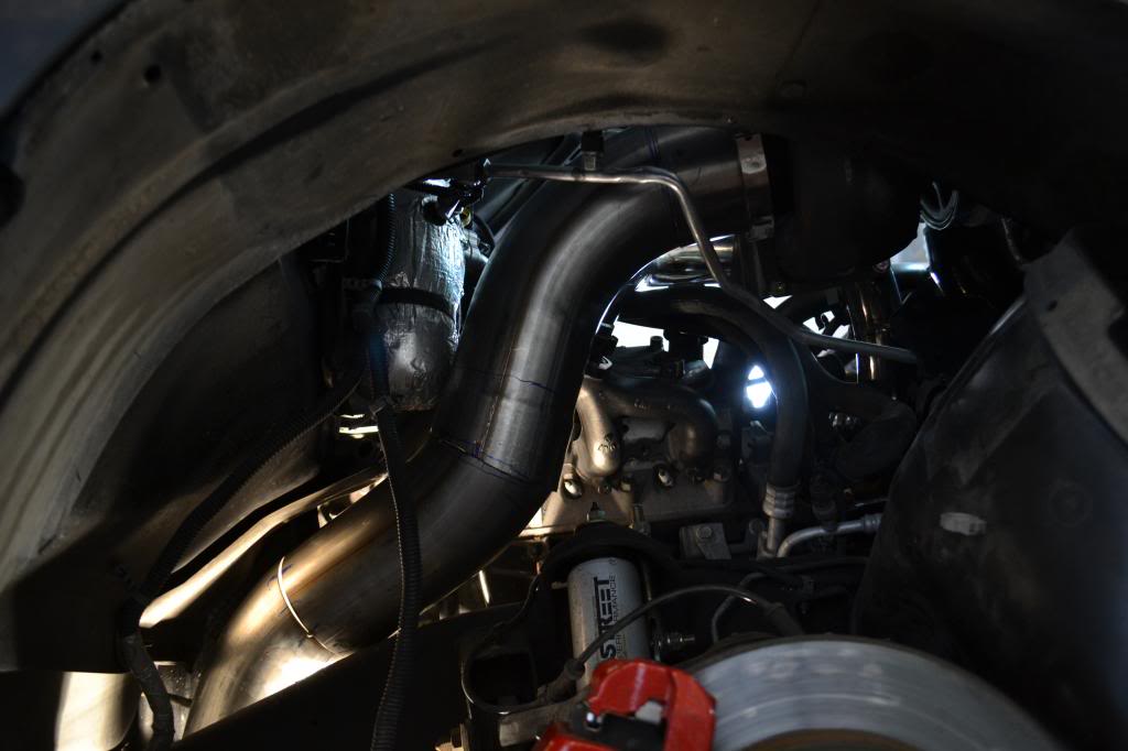

I respect what you are saying but spending a good time laying under the truck and checking the top of the engine for 4" space, it will not fit without cutting the 4" DP into two pieces and using v-band clamp in the middle near frame rail and/or hammering the pipe oval.
But even oval 4" will not fit as one piece if made oval near the frame rail bcause the whol 4" DP has to be driven in from the top of the engine or from under the truck. I don't see that happening with one piece 4" DP.

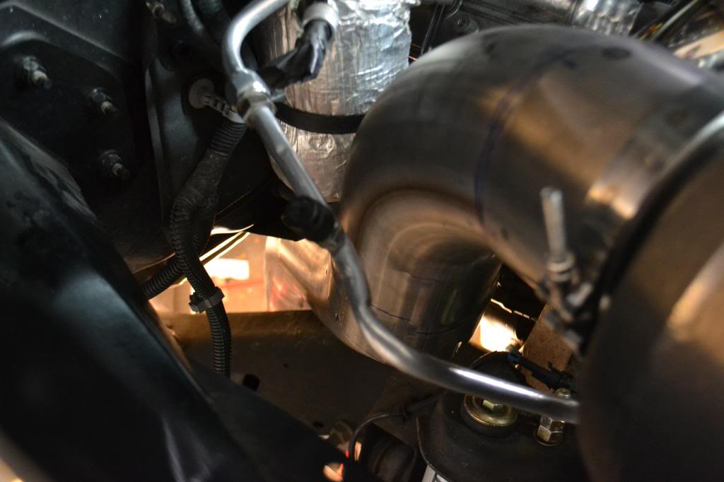

I will post a pic to make it clear why on my turbo kit it is hard to fit 4" DP. The cross over flange on the tabular turbo header get in the way of the DP near the chassis frame. If that flange is up a little more, it would be perfect to fit even 5" DP.
So, to say 4" or 5" DP will fit, I will have to cut the turbo header bottom flange, move it up and extend the cross over pipe up to reach the new raised turbo flange location.

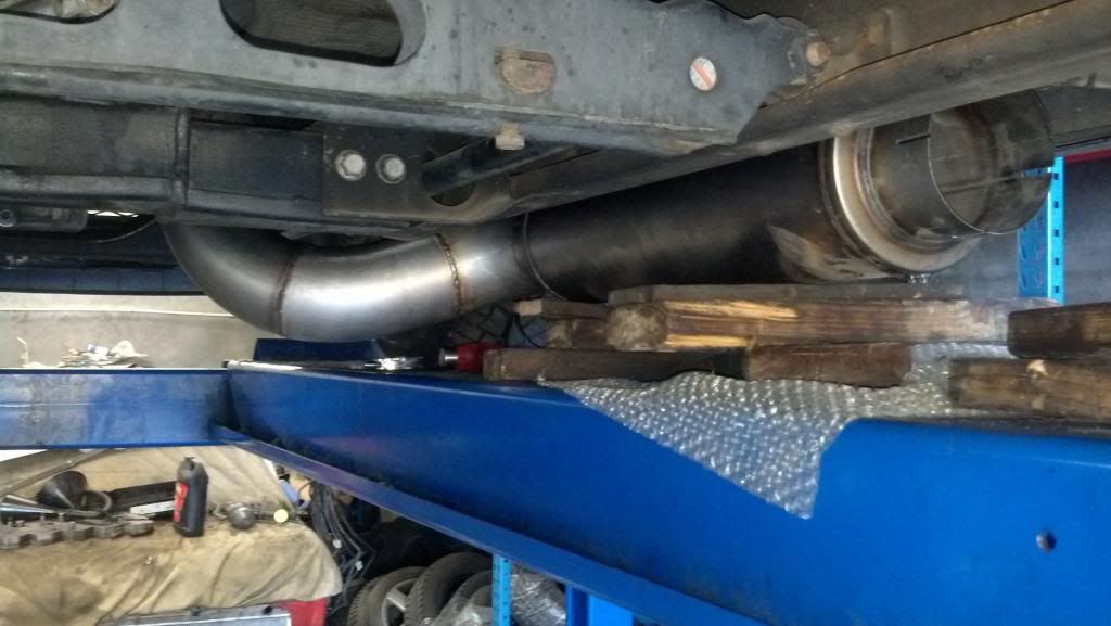

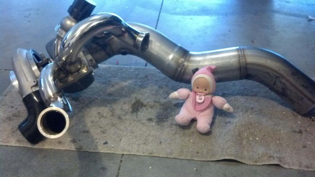

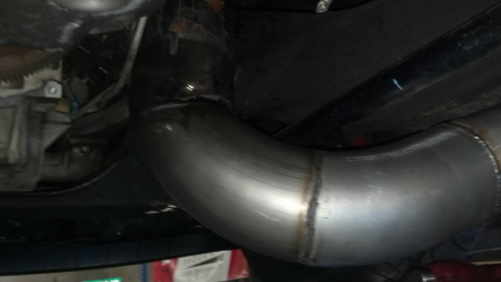

Post a pic of your 5" DP, if you don't mind, from top of the engine and from the bottom of the truck. I want to see how you squeezed 5" in there while me and others say 4" will be hard to fit without chopping a slice of the pipe.

Your set up will not allow that I fit. With out heavy modifying.
We have build 5" kits. Not really needed unless you are running 5" exhaust, open dp, and MAX hi power. 1500+.
Your crossover pipe will let a 4" fit. But will take work. The pipe has to snake around the flange to the turbo.
4" dp, not need unless well over 1000hp.
So if you want to make a larger downpipe fit. Yes; you will have to modify something, or purchase another Set of pipes built for that larger down pipe.

like i said 4" would be a walk in the park, do you need a 5" no probably not.
