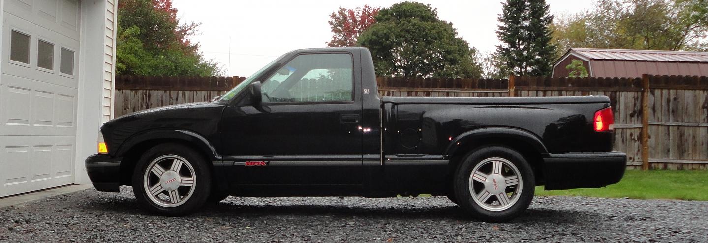

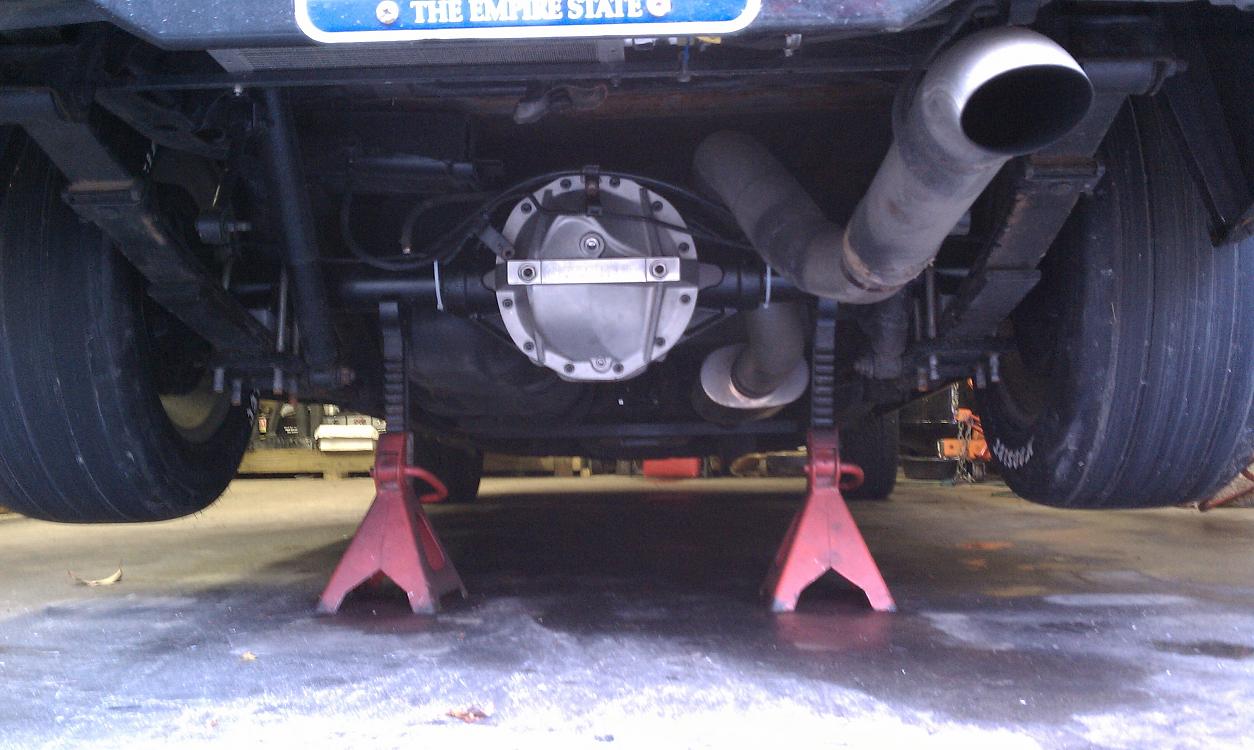

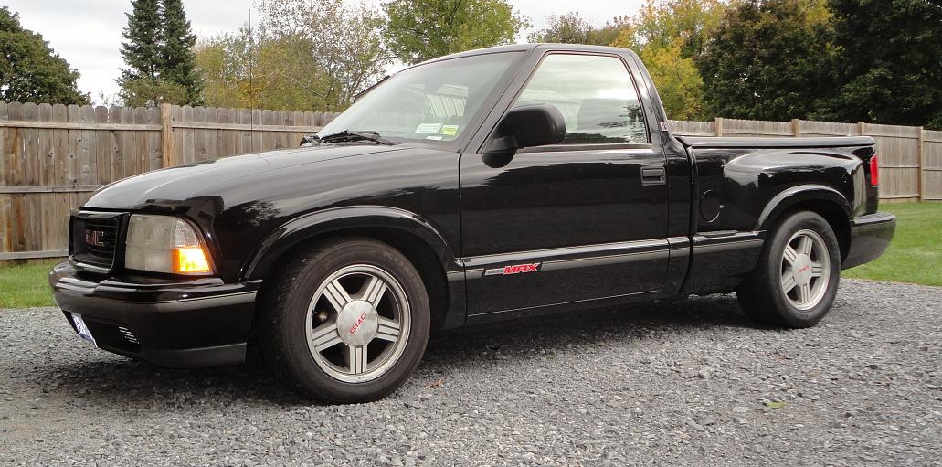

first off, this is my truck. a 99 gmc sonoma, with a LQ4, 4l80e, and a moser 12 bolt.
