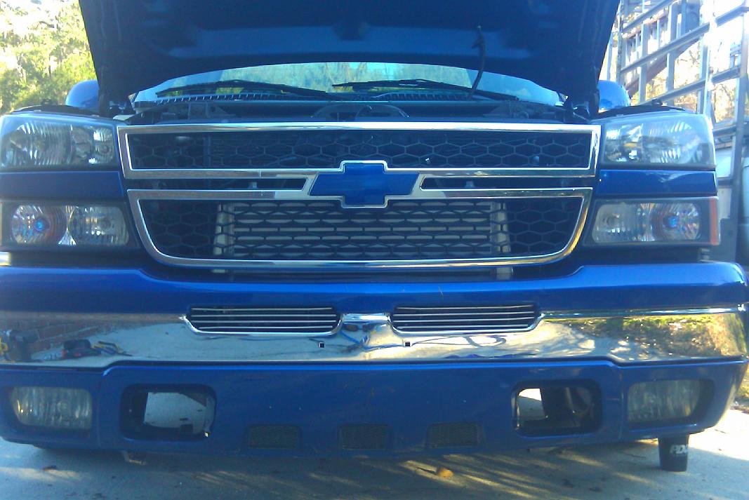

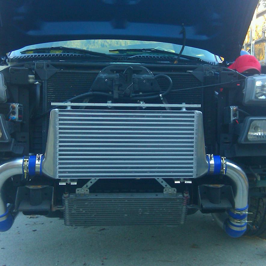

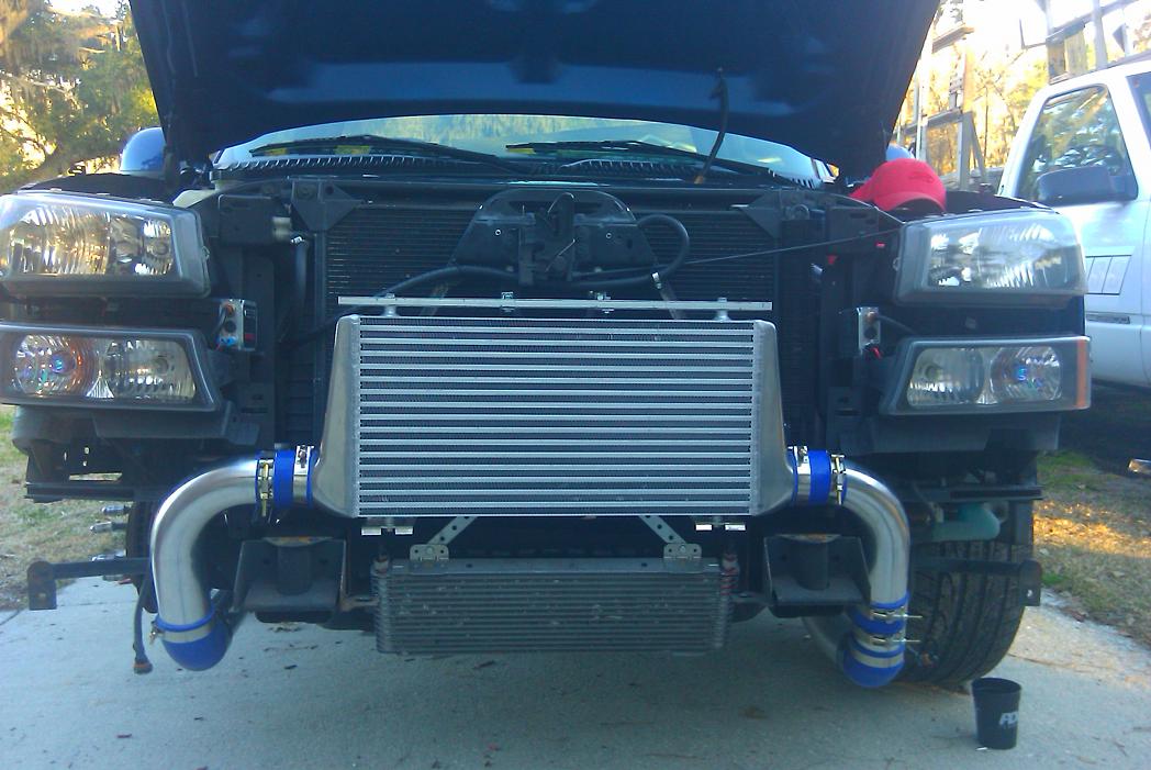

Hey man I was running into the same problem with my truck being lowered. So I decided to put it behind the grill. I believe mine is 32x12x3 if I remember correctly, let me know if you need any help I am in savannah.
dang, that is a nice I/C set up! Looks just that cool in person too.
Thanks for the kind words man. About to get started back up on this thing, ready to hit that 500rwhp
