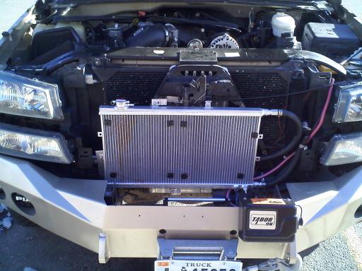

finally got iat's down 10* above ambiant air

That should be up against the radiator. The air is just going to go around it.

It's got two 10'' fans on the back side 1000 cfm a piece works pretty good so far

It's cold here too in Wyoming. haven't hooked fans up yet iat's with the heat exchanger that came with the 1900 kit were 180's at the end of a hard pull now they hit 100 but it is cold here. Frozenboost.com (24x12x1) Heat exchanger and fans were $200 had to make my own brackets
If you had 180* IAT's at the end of anything you have another issue. I suspect you had air in the system and purged it out with the new H/E. Nice work on the install !

This is the third one i've tried The little maggie one just wasn't that good i thought it was air too but it wasn't.
