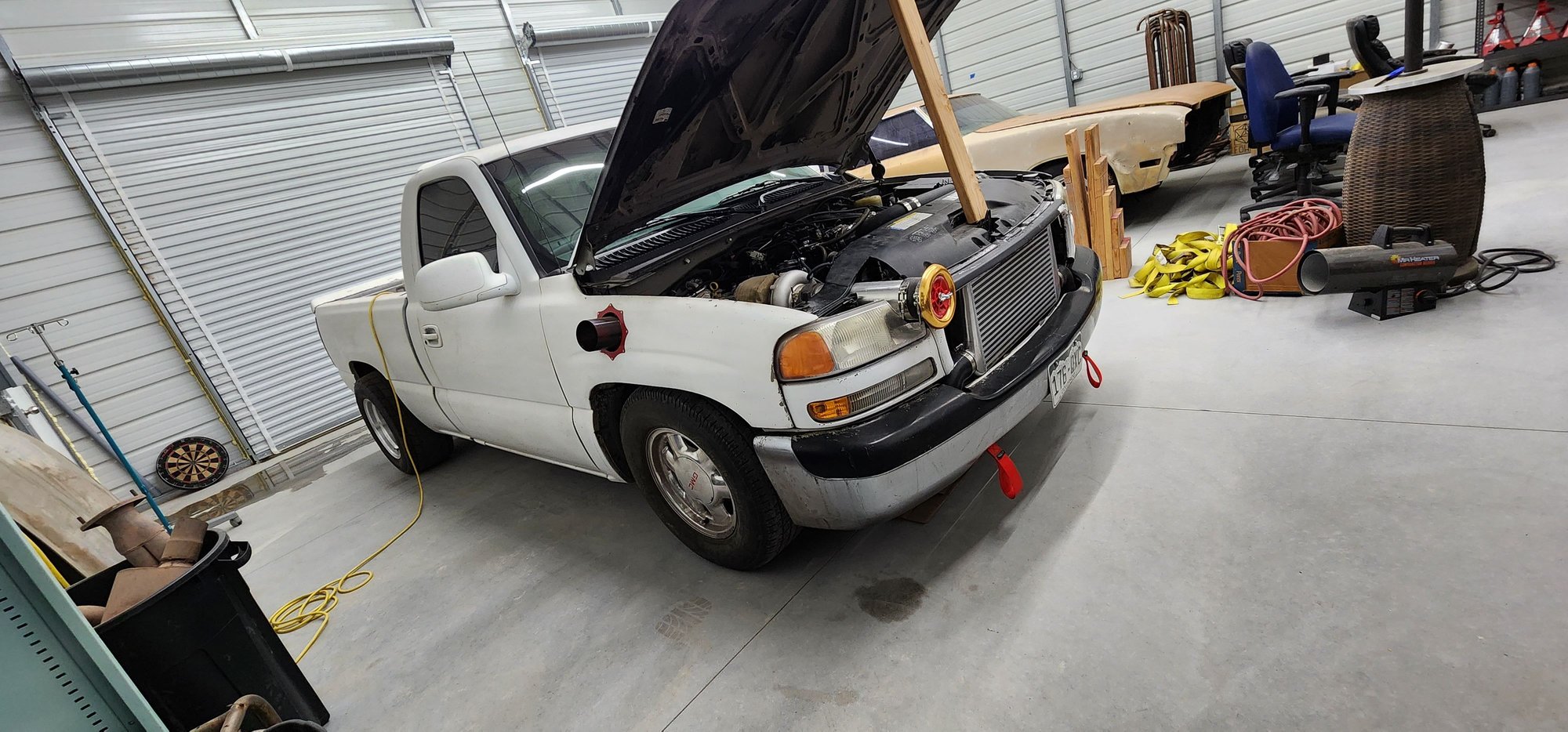

What's up guys, been a while since my intro here. But I figured I'd post the results I have so far on my truck.
To recap my truck is a 99 Gmc Sierra rcsb.
Mod list:
4.8 bored .030 over
Gen 4 rods
Summit pro Ls pistons(2cc dome)
Summit stg 2 turbo cam
Pac 1219 springs
Smith bros Trunnion upgrade
243 heads milled .030
Melling oil pump
Tbss intake
Vs racing 78/75 billet gen 2
Vs racing Wg
Silicone intakes innercooler
ebay fpr
Ebay 92mm tb
Msd 2 step
Hot side- flipped mani. Homemade
Turbosmart boost controller
-6 fuel lines
Dual walboro 525s in tank
Pump E85 only
SEP 1500CC Injectors
th400 with jakes stage 3 rebuild kit
Circle d 3600 tq converter
B&M pro ratchet shifter
Caltrac traction bars
Custom driveshaft
Detroit trutrac lsd
4.11 gears
HP tuners
Oem ecu

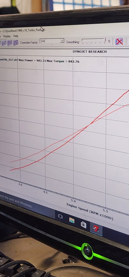

I think that's about the jist of it, or at least the majority. But the first trip to the dyno made 736hp/605tq @ 15lbs. Did some tweaks and came back for seconds to make 982hp/843tq @ 27lbs. Hopefully I'm posting this in the proper place, if not sorry. Please feel free to move, its been a while since I've been on. Catch my vids on tiktok(pvosscustoms) & youtube(BS&T GARAGE) 🤘

Have you taken it to the track yet? Wonder what times you could get

Making some steam and nice straight-forward setup.
I assume head studs and LS9 HG's?

I haven't taken it to the track yet, still trying to get use to the power. I have zero saftey/sfi rated anything on it so my first run is likely to be the last. Tuner said if I can hook I'll likely hit low 10 to high 9. So fingers crossed.
Yes, it does have ARP head bolts and an OE thickness head gasket. I did have a set if cometics on it but swapped due to the milling and domed pistons. Just to be on the safe side. Was worried the ptv would start a make out session, and nobody needs that. 😁
