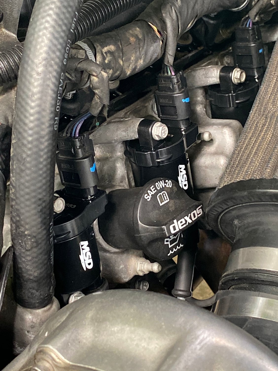

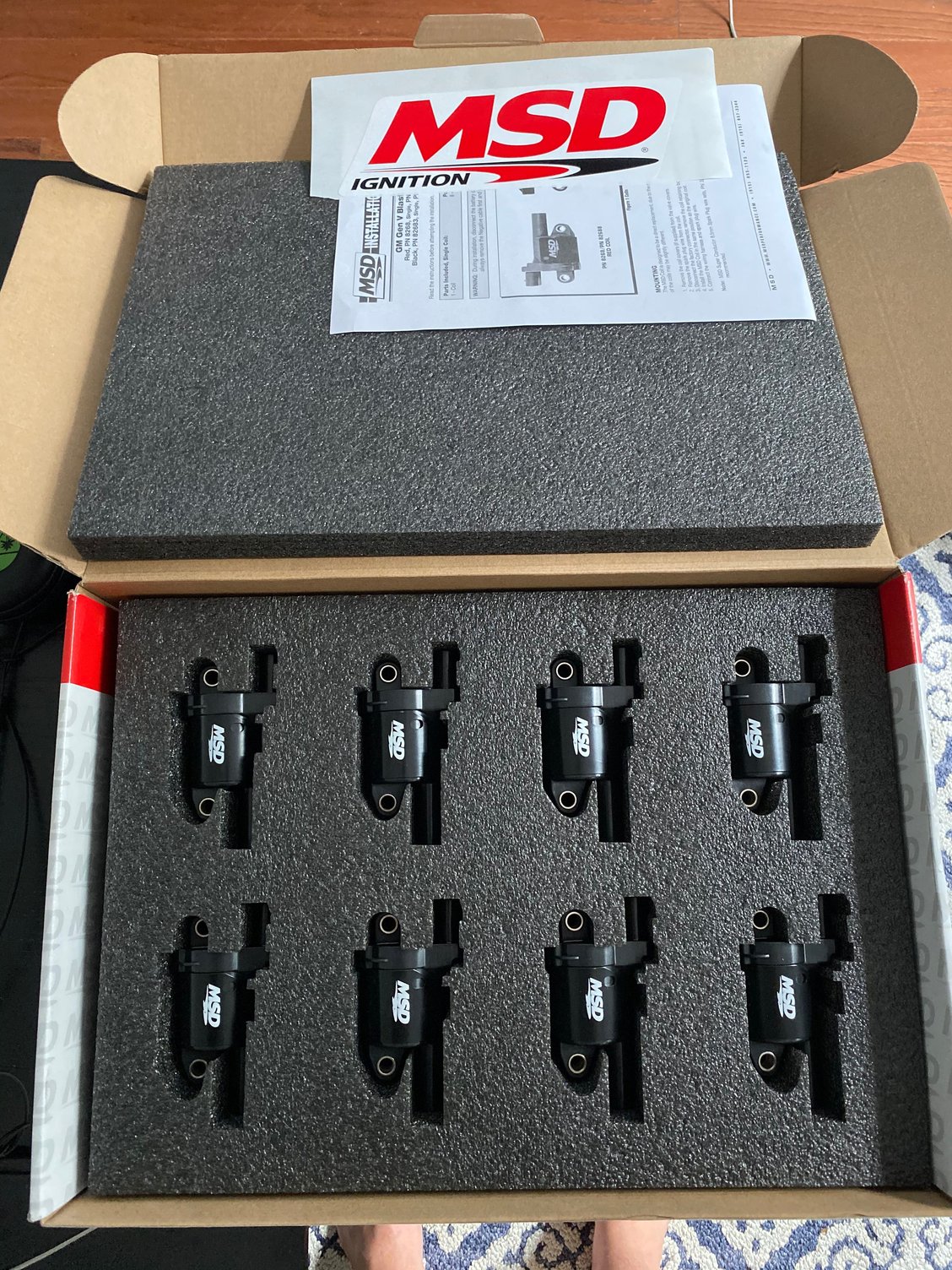

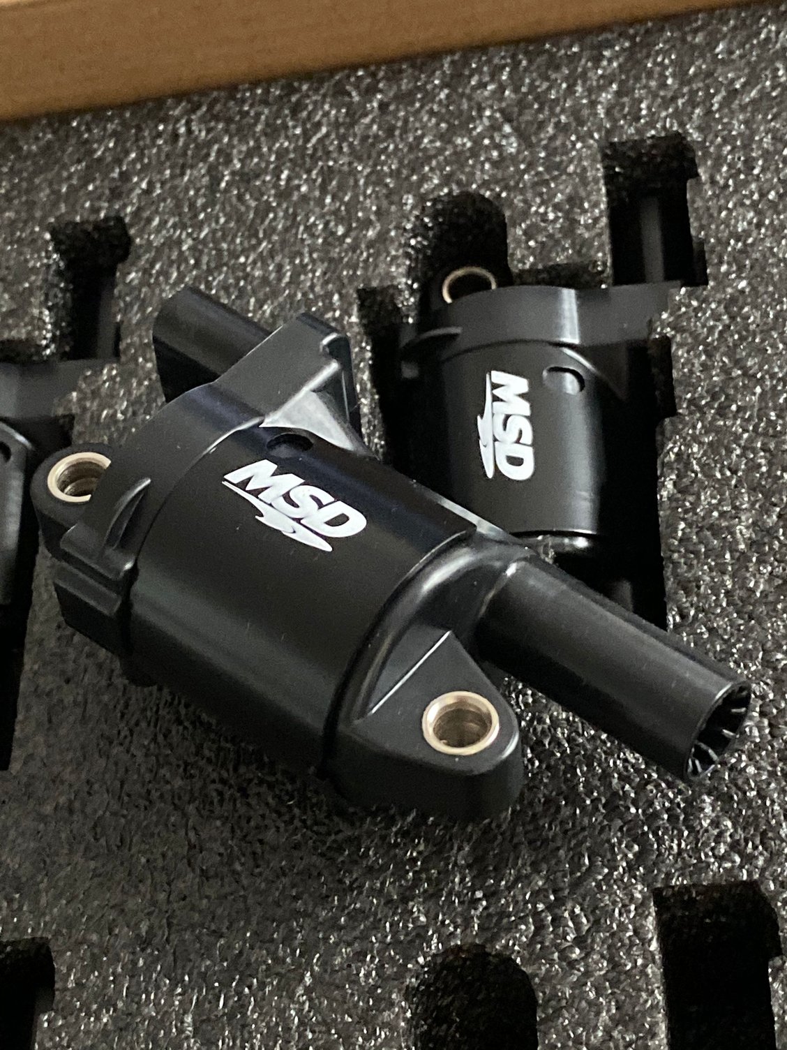

Weekly update: I had to go out of town this past week and told my friend to order up the MSD coils through his shop. Fast forward to Friday, and I had them in my hands!

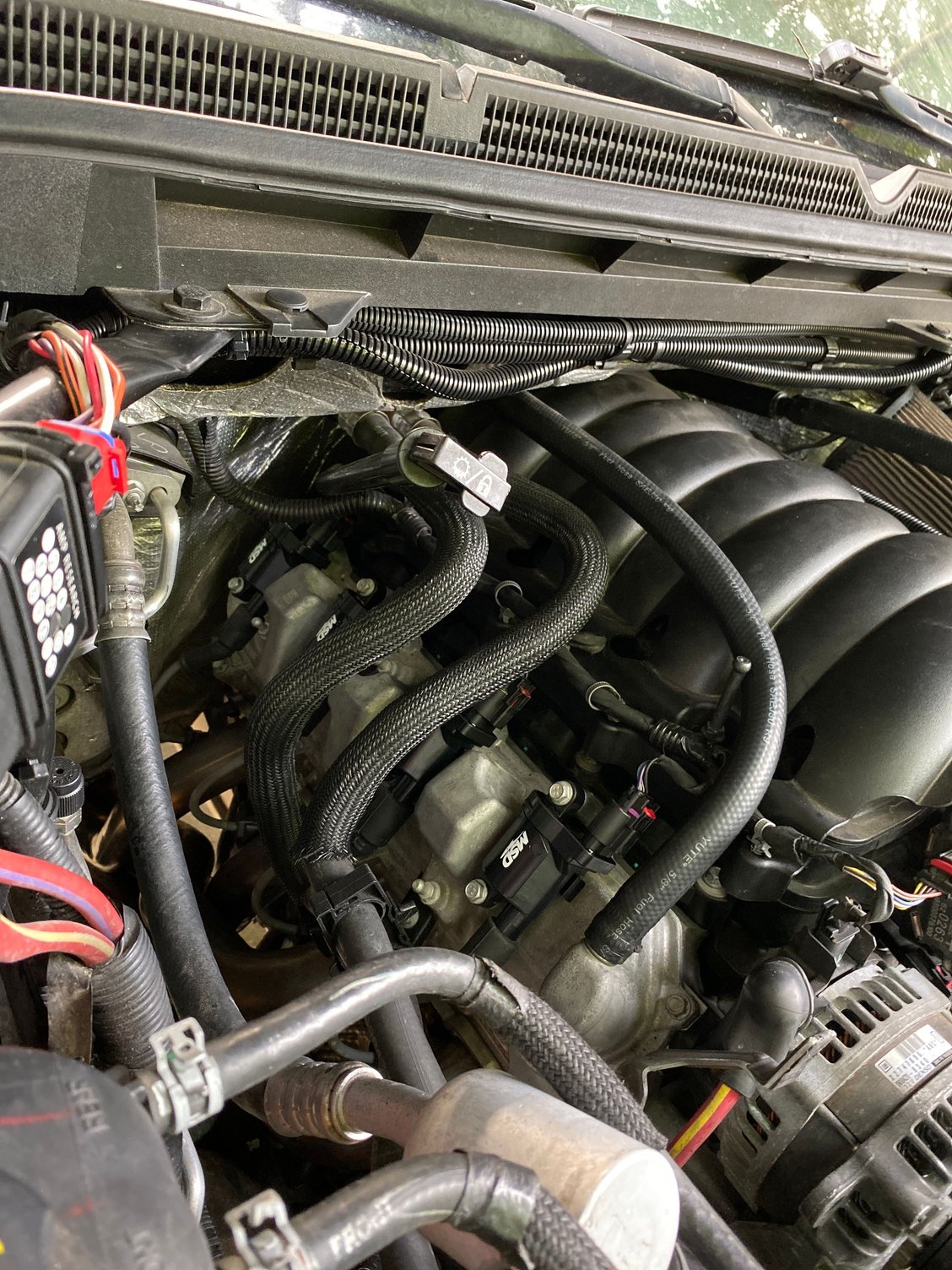

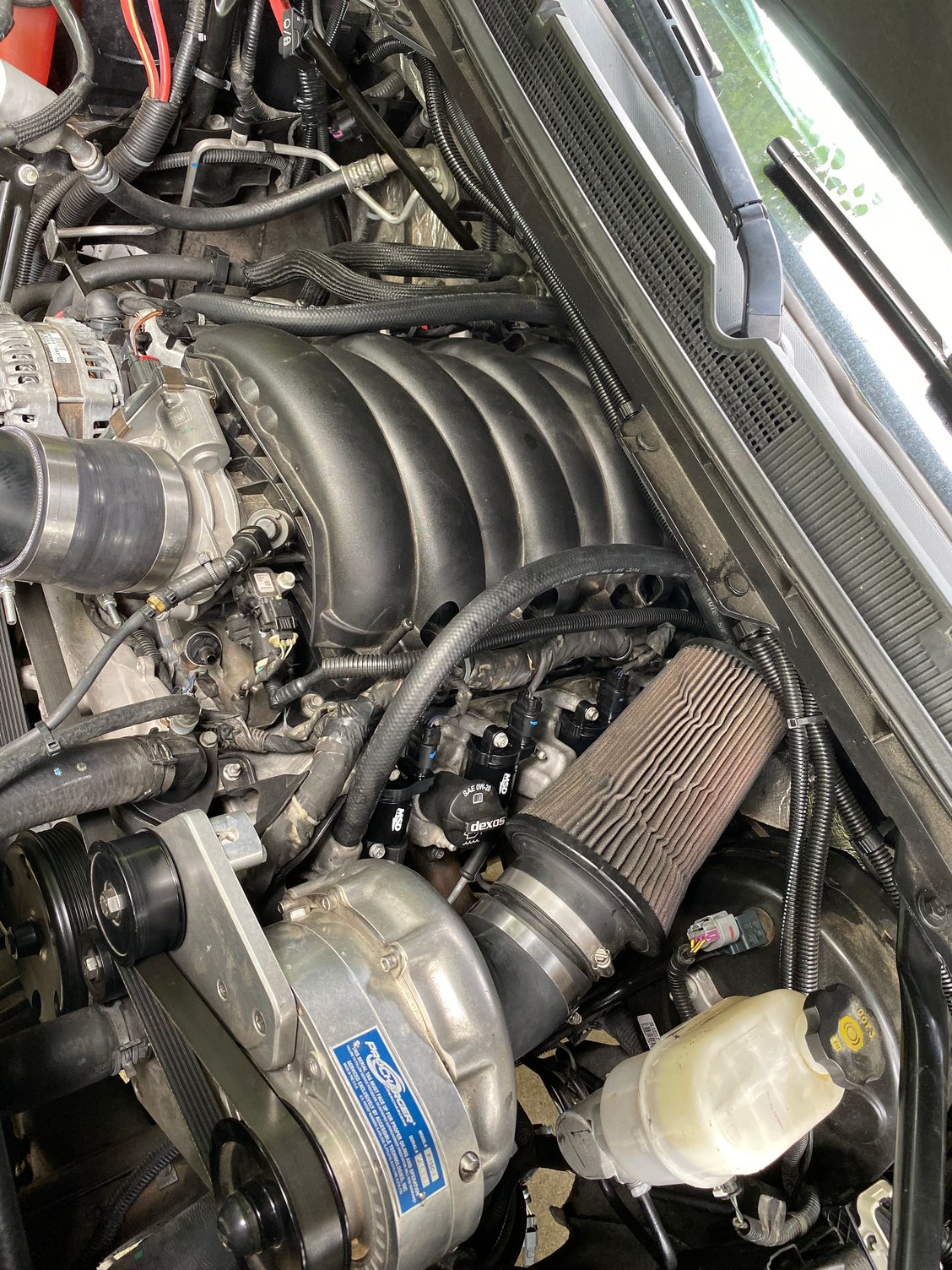

I think it’s time to clean up the engine bay a lil bit lol. Here they are installed:
I put them in this morning and she runs like a champ again! No broken coil harness clips, no ripped pants. For once, it was probably the easiest install ever where nothing went wrong! I’ll keep an eye on it in the coming weeks to see if there are any changes with the way it runs.

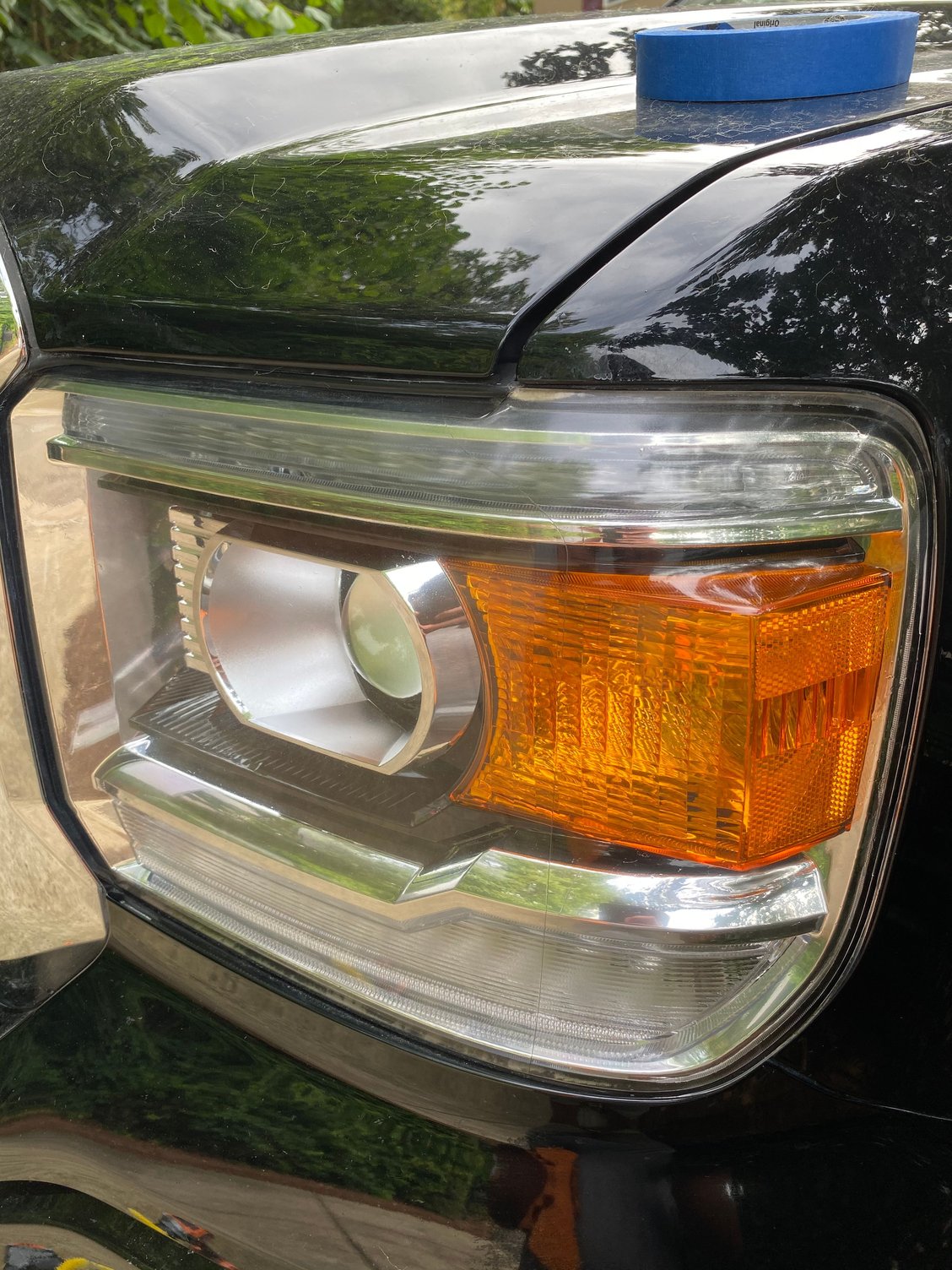

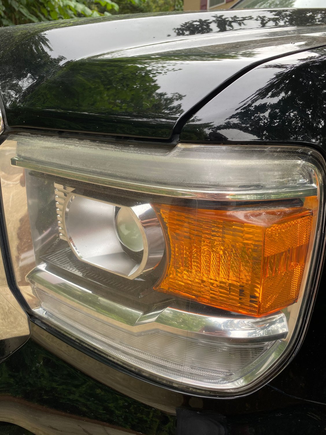

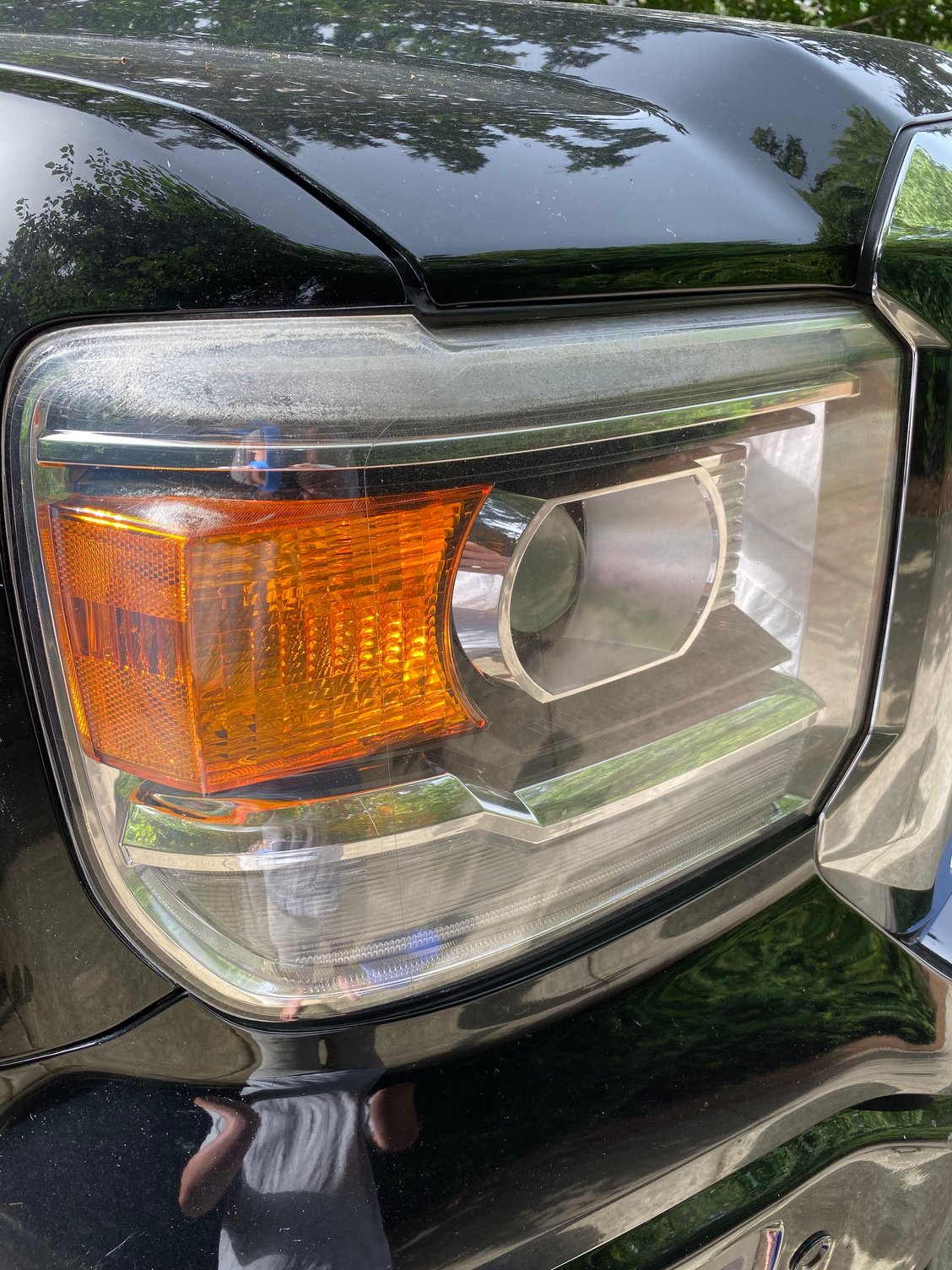

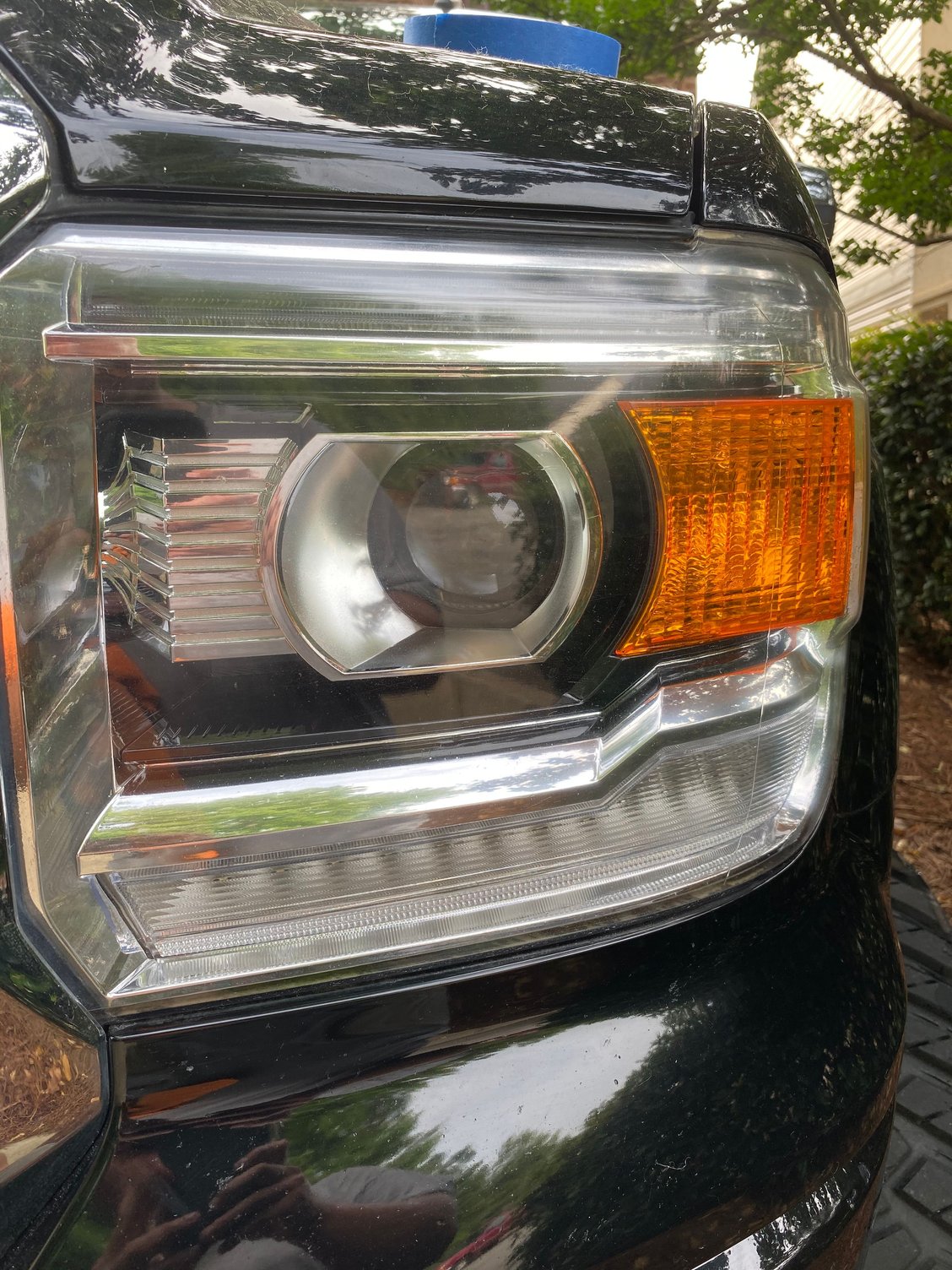

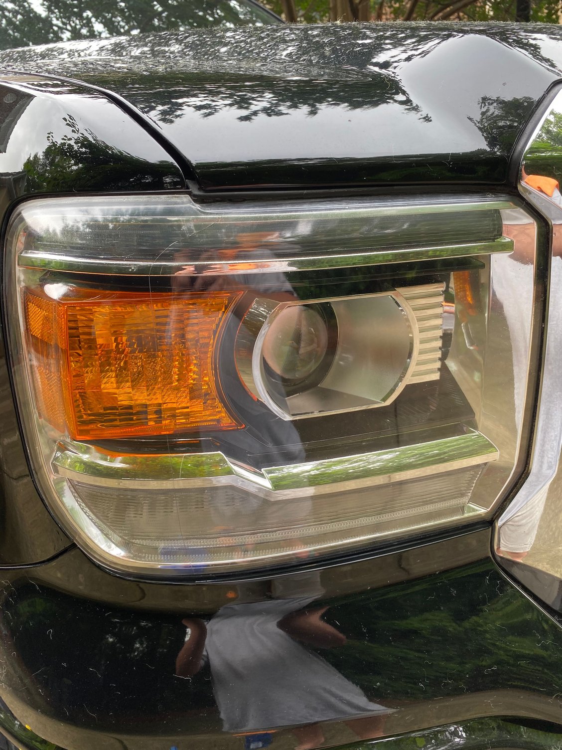

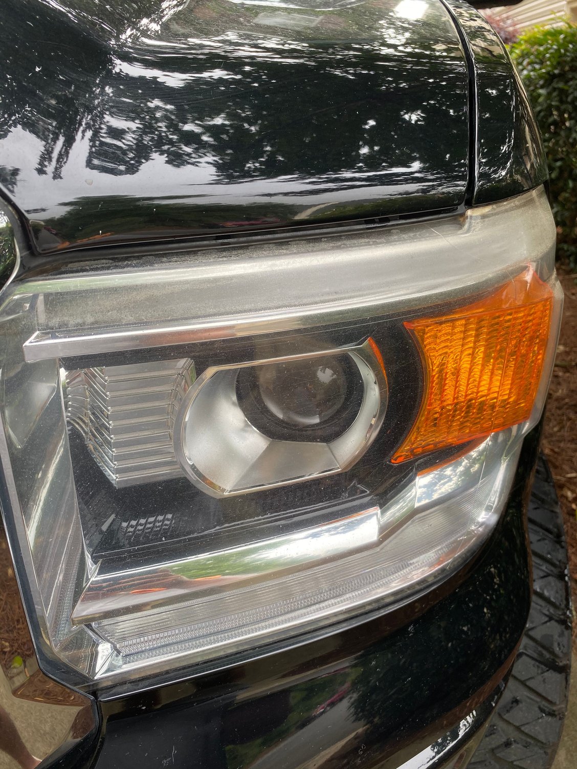

Finally, kind of random, and while dodging some rain, I ‘restored’ my headlights. They came out okay. It was bothering me that the tops of the headlights were starting to oxidize. It also gave me an excuse to use my new Ridgid drill I bought for work haha. Let me know what you think!
Before:
After:
