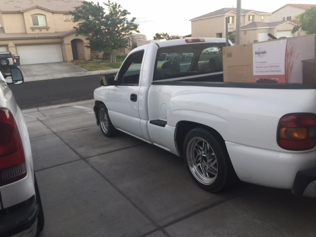

Starting part 2 of my build. To start off I went with ported 5.3 heads by PRC, BTR stage 2 NA cam for the LS1/2's and supporting mods for timing chain heads, trunion upgrade. long tubes and a tune from blackbear.
Overall the truck is really fun on the street but first time at the strip i ran 12.7 in the 1000FT. I was hoping for better but i have stock converter, open diff and 255 section width tires. So i know i can pick up a second and a half with stall, gears, tires and a limited slip. but i'm looking for something more.
I have a T56 ready to go in, plan on doing axle upgrade and aiming for a handful more horsepower.
I was thinking the stage 5 kit from trick but i don't know how a big turbo will respond to a manual trans, since i can't hold boost between gears, do you think i might be better off with a smaller ball bearing turbo? i'm not really sure on that. Plan on keeping the stock PCM so anti lag and no lift shift aren't really an option.
Any advice on maybe using the manifold from trick and piecing together a kit?
going forced induction i will source a new cam, probably stick with BTR's stage 2 turbo cam. but i want to keep my ported heads, stock intake manifold and throw in injectors and upgrade the fuel pump to support my fueling needs.
my goals are getting reliably in the low 12's high 11's in the 1/4 mile. I don't want to dump a bunch more money in the truck and be disappointed with power again, so i want to do it right this time around.
any advice is much appreciated. I'll get ahold of the guys from trick if they don't hop on this thread. Thanks!
