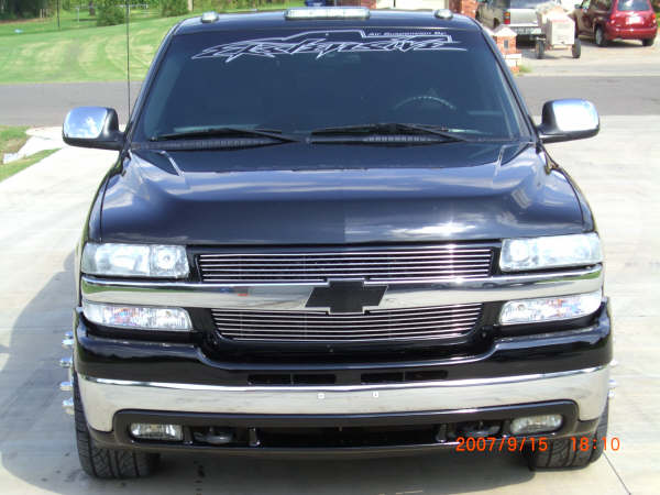

Ok I found it... It's not a tahoe valance; It came on 2003 3500 silverado's and is called a Deflector. GM# 15709110 on gmpartsdirect
Here is a helpful thread with pics for anyone needing the same info in the future. https://www.performancetrucks.net/fo...hlight=Valance
The truck in that picture is an 01, and he said it came stock on it. In 03 they had the newer style front end.
Your correct, idk why I put 03'. Regardless, it fits 99-02 front ends and that is the correct part #.
15709110 - 99-02 body DEFLECTOR ASM-FRT AIR (HIGH AIR FLOW) *CHARCOAL
