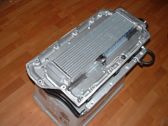

I stand corrected. I had spent a lot of time researching the intercooler design of the MP112 and how inefficient it was. I was unaware that the rotor design had changed so much to the TVS units. Even though the intercooler is no where near as efficient, the rotor design is also a drastic change. Here are some pics.
Here are a couple pics that were posted in another thread by KB Racing.
MP112 intercooler
TVS1900/2300 intercooler
