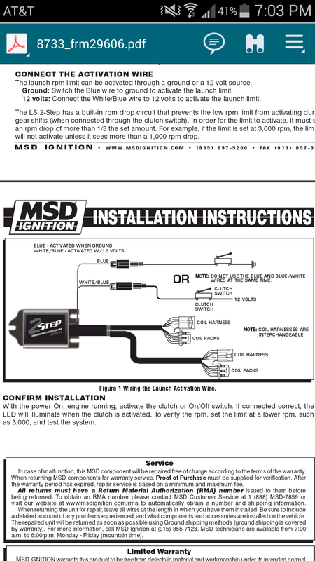

Size:  250.8 KB so according to this I can just run the blue wire to a toggle switch with a 12v source and ground and it will work. Is that right?

If you use the blue wire, you want the toggle to ground when you turn the switch on. Opposite with the blue/white wire. If you use the blue/white, you want the toggle to activate 12v. You use one or the other.

Got it! I think I would prefer the ground method. To deactivate I imagine I'd just have to turn the switch off
