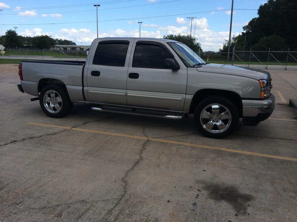

06 crew cab short bed 1500HD, get all the bonus's of the 2500 series with the ride of a 1500.
6.0 and 4l80, bigger rear end.. Win!

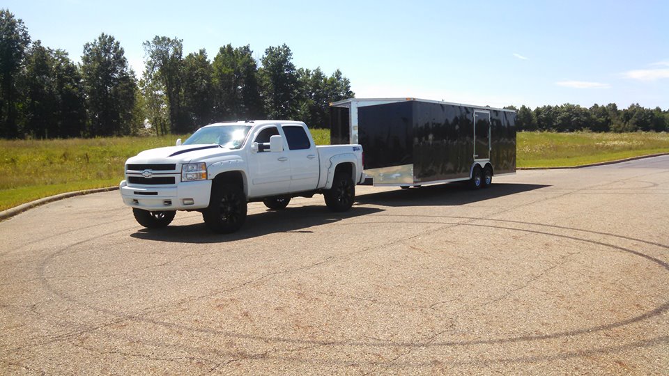

I tow with a half ton, truck also ran 12.5@113 last yr
stock rear, stock trans, air bags in these pics....I swapped to 3/4 ton leafs this winter with a 14 bolt but the 10 bolt and stock leafs held up for thousand of miles towing
Man that sounds and looks like an optimum set up for what I want to do with it. Is the 1500HD any bigger in size or weight than the standard 1500? Or is the only difference between the two displacement, transmission, and rear end?

Old Feb 26, 2015 | 06:05 PM
ezdaar's Avatar
Joined: Jul 2010
Posts: 629
Likes: 22
From: Houston
body size is same.
ride height is slightly lower.
Mine as you see it in the pic has 2" hanger drop in back to level it, didn't touch torsion bars.
Eventually I will 2" spindle drop in front.
Remove the 2" blocks from rear and adjust the shackles from 2 to a 1" drop.
Will give me, In my opinion the best look, being a 2/3" drop. with oem 20's and a good riding sidewall tire.
Will maintain factory ride and towing. while looking great.
