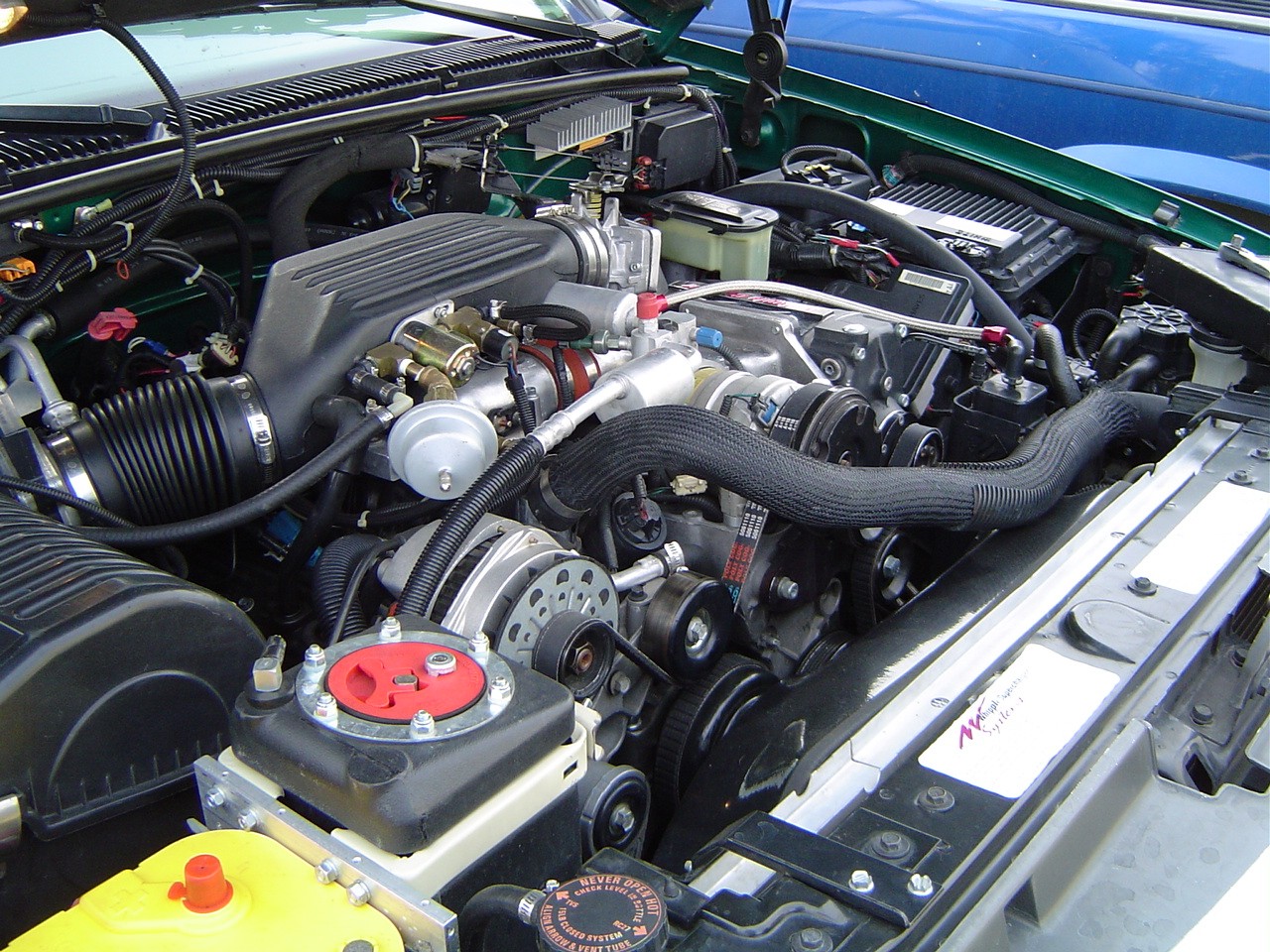

I use a 1-gallon Jaz cell for mine. This system is a Carrol Supercharging "Gaseous Intercooling" kit, and I think they stopped selling it three years ago. I have been running straight distilled water since it was installed. It does the job. If I let the tank run out it will ping bad WOT. I'm running 9psi. on the stock shortblock.
