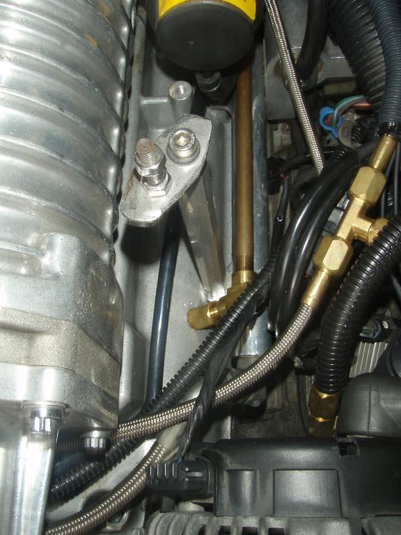

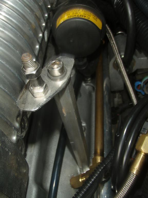

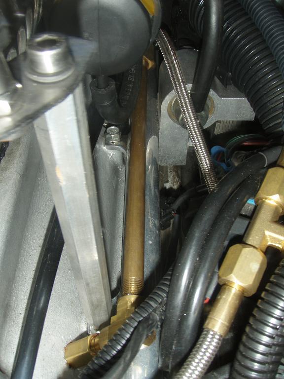

Ryan, how is yours plumbed on your Tahoe? Sig says Direct-Kit 4 Nozzles, please elaborate, and pics will help
Old Oct 12, 2009 | 09:58 PM
03tahoe22's Avatar
Joined: Sep 2005
Posts: 371
From: Palm Beach, Florida
2 Nozzles down each side with a hard line in between. I think all the nozzle are "5." The nozzles were tapped into the top of the intake and place in between two of the cylinder runners that are on the floor of the intake. I haven't gotten a full log on Hp Tuners yet but I can't see a change when I purge the system showing up on the iat sensor. The meth should be affecting the air after it exits the intercooler. The iat sensor is just a heatsoaking btich. A selenoid had to be placed in between the nozzles and the pump since there is extreme vacum in the intake and would just suck the tank dry.
