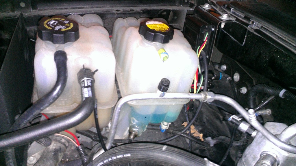

Back when I had my supercharger and used water/meth, I used a spare coolant reservoir. It looked decent, fit pretty good, but best of all the low coolant switch could be used as a failsafe when I ran out of water/meth.
