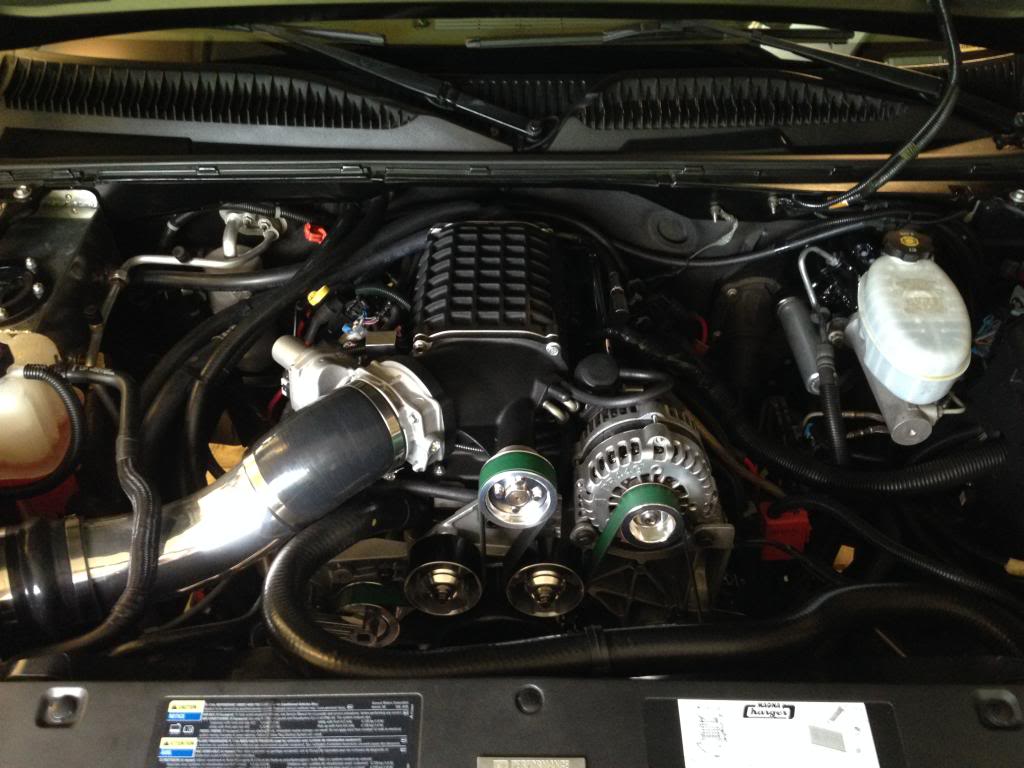

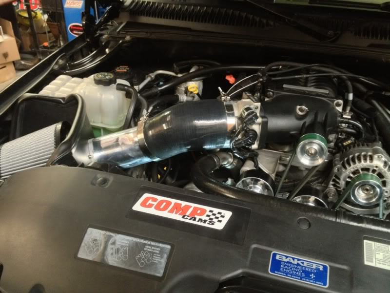

You need a 4" 45 bend with 4-6" of straight pipe on each side that you can cut where needed , you can also use the ZR1 piece you have also for the MAF bracket , then get a silicone 45 elbow to go from throttle body to pipe , then either another 45 or just a hump adapter to tie the air box in . Also get some of the nice looking T bolt clamps for a pro looking job
I'm not pimping my intake , just posting this for an idea of how I did mine ( mine is 4.5 " though , I reduced off the TB )

Tim, Pat, where you guys getting those heat shields? making your own?
I like my stock box, but im not opposed to getting rid of it

My filter and shield are AirAid.

Your my hero Roger , but I have hardly anything to show off , especially with you and Pat posting pics here
Smokey , my heat shield is from the original K+N kit I had , and the air filter is a big beeyatch from AFE, it's a dry flow and the same one I ran on my dmax .
