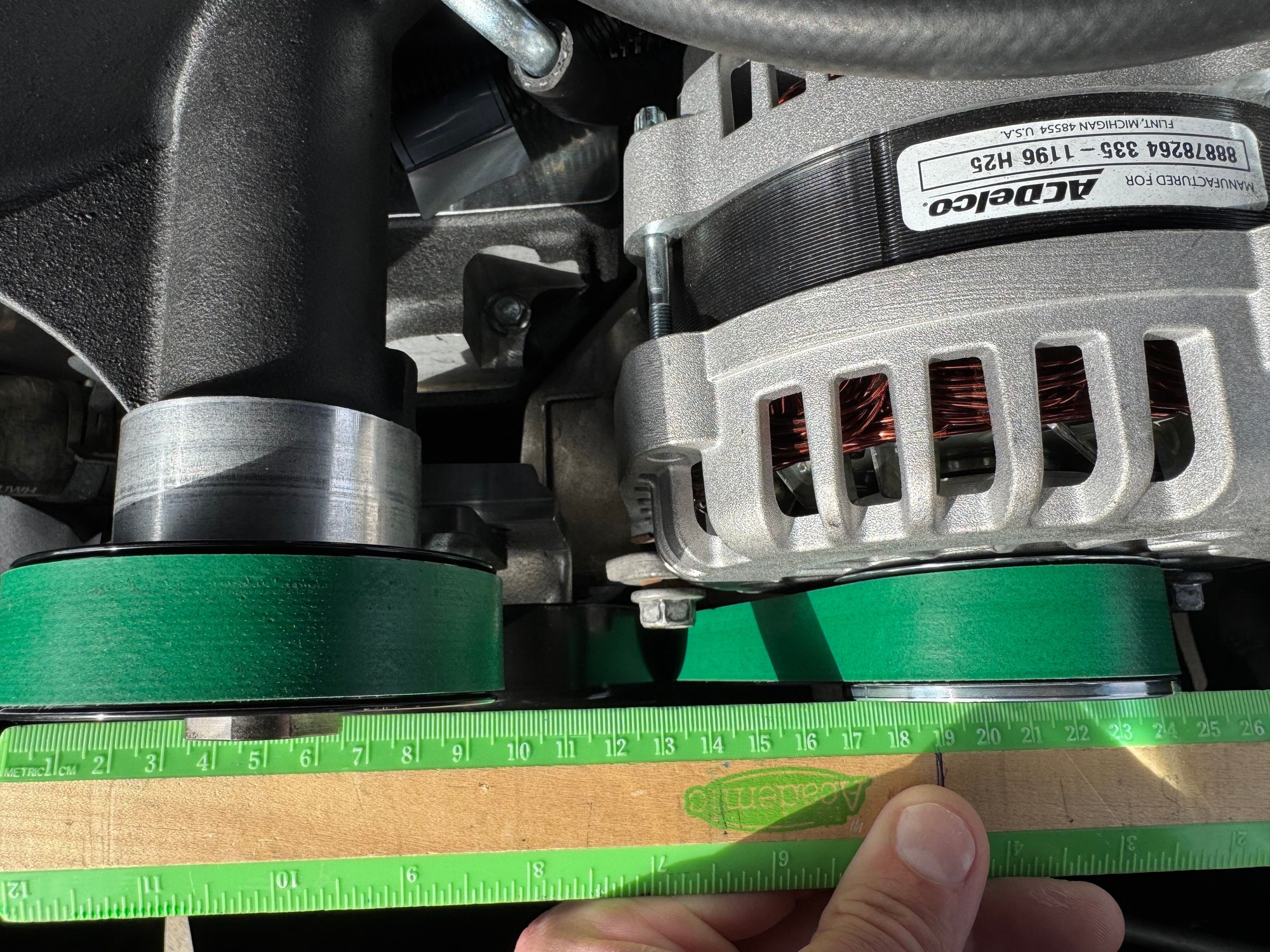

If you put the belt on proper where it is seated on all the ribbed pulleys and let it idle how does it look? Is it wanting to walk off just idling?
It looks fine idling and isn’t trying to come off.
I just drove the truck on an hour trip out and another back and the belt stayed on but no WOT. I’ll try and get outside tomorrow with a ruler and see if I can tell if the pulleys are straight.

Ok, so it was hard to compare all of the pulleys with only a 12” ruler but as best I can tell, the generator pulley is lined up with the power steering and the supercharger might be slightly back, but the generator pulley is thicker. The adjustable idler pulley is slightly off compared to the stationary one. I can’t compare the tensioner to anything due to where it is.

I had the same problem, water pump pulley alignment was off and I needed the HD tensioner. Just go ahead and get the 8 the rib version as you can run it with a 6 rib belt.

I didn’t think the water pump would make much difference since it’s a smooth pulley. I replaced the water pump with a new OEM pump less than a year ago. I’ll order the HD tensioner but it won’t help me with our trip. It really sucks I’m going to have to worry the whole time about the belt coming off or partially coming off and getting destroyed. And keep my foot out of it…

I’m gonna chime in here again. I do not think you have an alignment issue here. I do think the HD tensioner will be helpful. Your statement “ i recently installed a magnuson supercharger” is my basis for all of my suggestions and conclusions. There is a learning curve on having a blower and the way you accelerate and decelerate. I have thrown tons of belts and broke several tensioners all due to being too aggressive. The problem is not going into boost aggressively but more so getting in it aggressively and letting out suddenly. I personally believe you will benefit from the HD tensioner as many others have in the past. Including myself.
