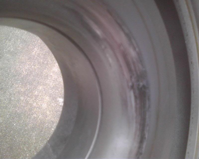

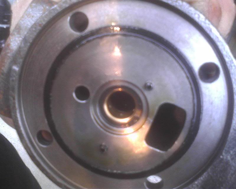

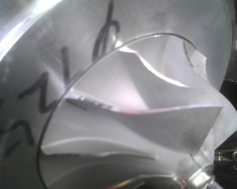

I tore down the turbo this evening, you can see it was rubbing the housing. It had oil flow, the bearings look good, not burnt, damaged or wore. There is minimal up and down movement but it did move back and forth about a tenth. I pulled the turbines off and pulled the shaft, shaft is perfect, and the oil in there was clean? I can see the bearings are held in by c-clips, so what causes the shaft to go front to back that much.
