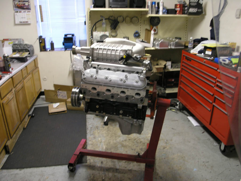

Just a couple of pictures as move towards the dyno. Ran into a couple of parts issues and the tech broke his arm so we a week behind schedule. Should get on the dyno this week, I will keep you guys informed.
Attached Thumbnails Magna Charger Worth Puting On A 408ci-p1010226.jpg   Magna Charger Worth Puting On A 408ci-p1010228.jpg
