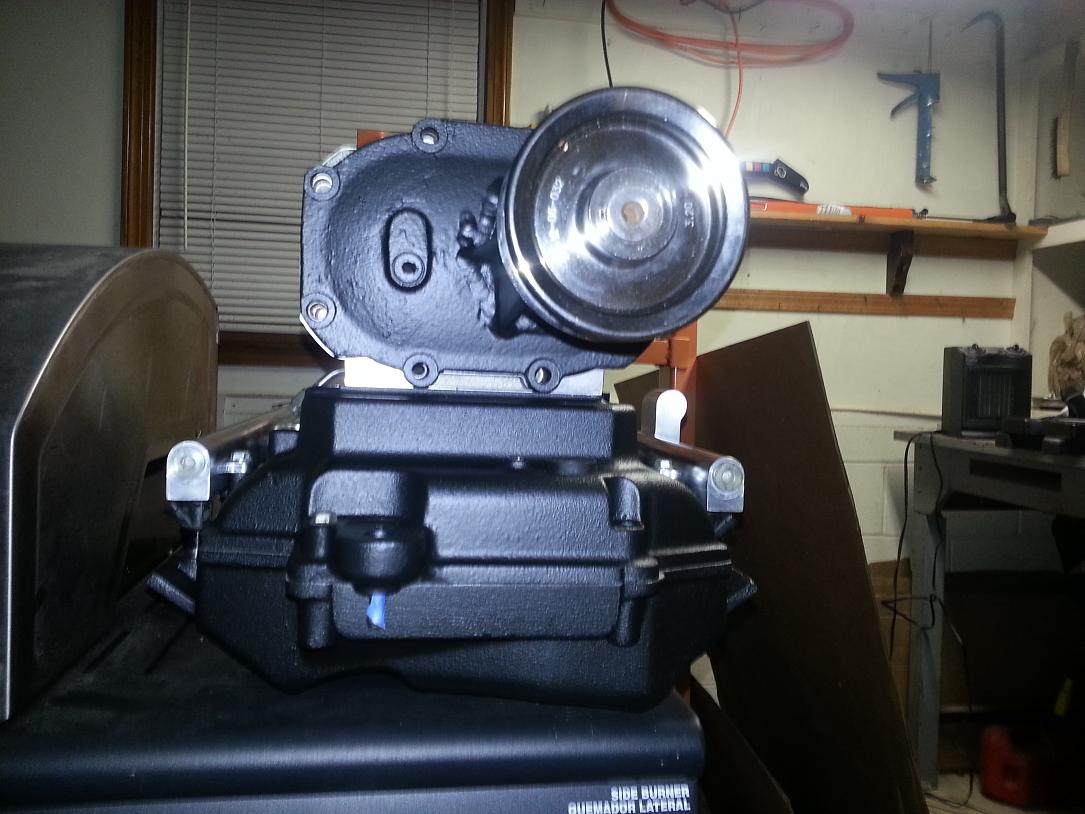

I have tried to get magnacharger to sell me the intake. They will not. They say they will repair one but will not sell just the intake. I called whipple and they would sell just the parts but for the lower intake, upper intake, and fuel rails it was $2100. So I just kept looking and found a complete Magnacharger mp112 kit. Got it cheap and rebuilding it now.

Heres my settup. Waiting on some seals.
