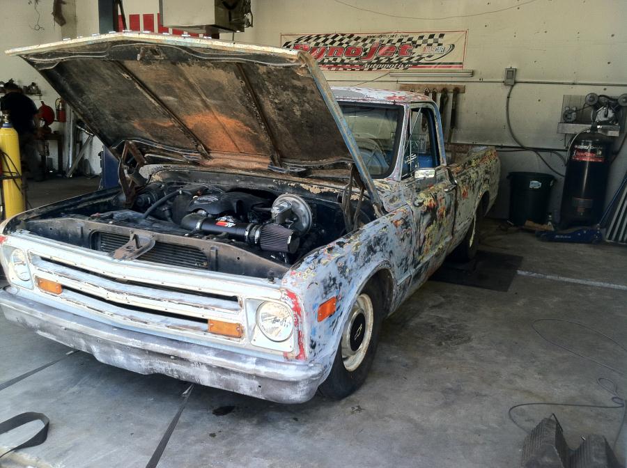

Trying to decide what turbo to go with.. I Drive it daily. It's a 68 pickup with stock lq9 and 4l80e. Not sure what cam, stall, and turbo to go with. It's got 14 bolt rear with 3:73 gears in it.. truck weighs 3700lbs... I've got a edelbrock super victor intake that I would like to put on when I turbo it.

Like that stealth look huh? Think I would do a little bodywork and primer first lol. Gonna be a fun project tho.

Im doing a similar build in my LQ4 71 C10 i picked an S475 T6 1.10 AR Ill let you know soon how she reacts to it? You have a nice start though with the lq9 platform in that rig

I would leave the body just how it is as long as it is solid. Don't have to worry about dings and no one will ever guess it will pull like it does.

Cool truck. What's your budget on the turbo?

dont wanna spend more than about 3K
