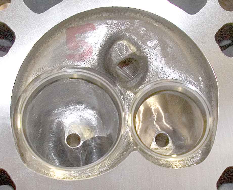

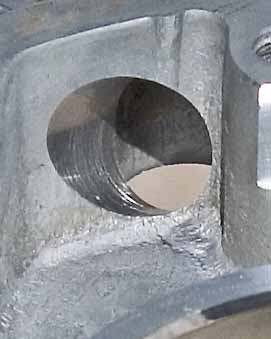

The 1999 and 2000 year model LQ4 has cast iron heads that flow identically to the stock LS1. These heads have round exhaust ports and do not flow on the exhaust side as well as the D port 317 heads. Also, the do not dissipate heat as well as the aluminum heads. The iron heads are considered better for torque and the aluminum heads are better for HP. I kept the iron and ported them and have had them flow tested. They work very well for me as I'm all about torque.

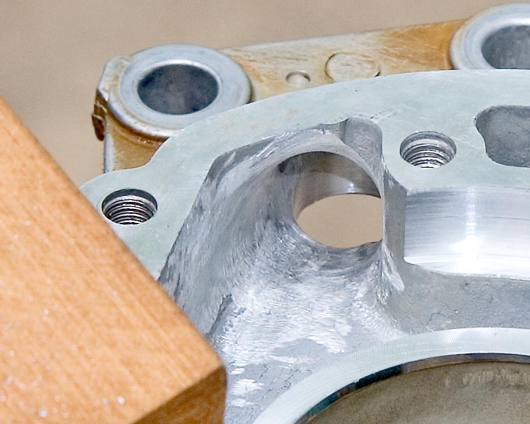

See attached Pictures. I've also included the before and after on the oil pump outlet porting.
