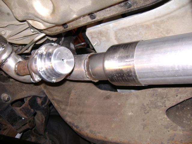

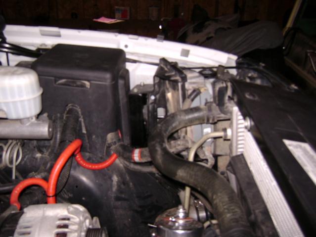

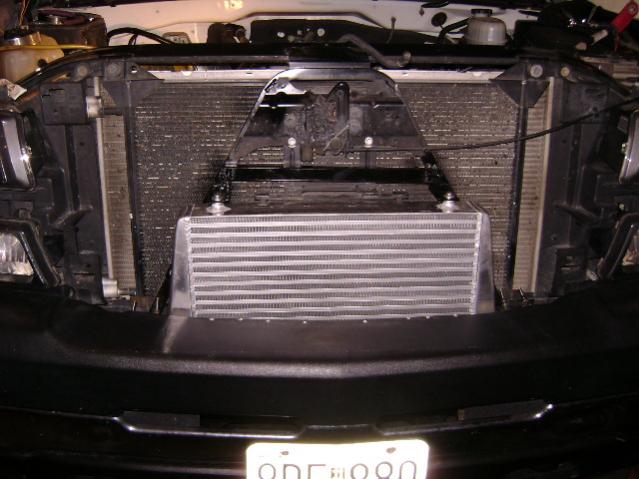

Well awhile back Kyle had a sale and I picked up one of his turbo kits with a MP70mm. I started the swap on my 05 2500HD with 6" lift and 315/75/16 BFG knockoffs. I had to make alot of alterations as my truck isn't as easy to swap in the intercooler and cold side 3" intercooled pipe runs through the core support ala duramax style.. I've also made sure that any change to the truck was the way I wanted it. (pcm and battery remount) The truck has been running on Motron 60's and 2Bar tune for a couple of months in preperation. enjoy the pics. Exhaust is the 3" downpipe to a 3"-4" adaptor, then 22" of 4" feeding a stock Duramax muffler for the moment. I haven't had a chance to finish the last minute stuff yet, like the wastegate connection still needs to be welded to the downpipe.
Attached Thumbnails KBRacing on a 05 2500HD with 35's-11921967889_263639702_im1_05_565x421_a_562x421.jpg   KBRacing on a 05 2500HD with 35's-dsc01714.jpg   KBRacing on a 05 2500HD with 35's-dsc01744.jpg   KBRacing on a 05 2500HD with 35's-dsc01754.jpg   KBRacing on a 05 2500HD with 35's-dsc01763.jpg

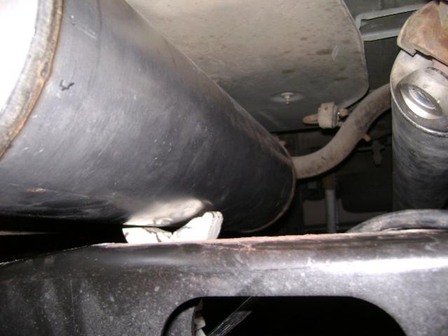

I had to reuse some of the "Bubba" true dual exhaust to clear the driveshaft, so thats not a happy thing for me.
Attached Thumbnails KBRacing on a 05 2500HD with 35's-dsc01765.jpg   KBRacing on a 05 2500HD with 35's-dsc01768.jpg   KBRacing on a 05 2500HD with 35's-dsc01774.jpg   KBRacing on a 05 2500HD with 35's-dsc01756.jpg   KBRacing on a 05 2500HD with 35's-dsc01761.jpg

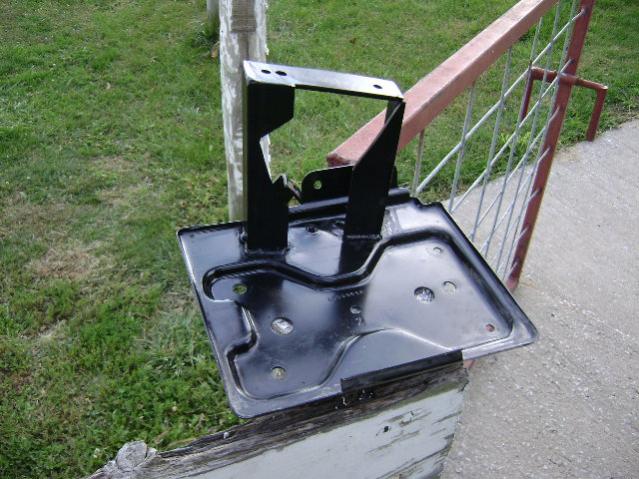

Also I got a pm on the pcm mount, its actually welded into the battery tray and is now more solid than stock. Also the Manifold Kyle made is actually nitroplated now.
Attached Thumbnails KBRacing on a 05 2500HD with 35's-dsc01735.jpg   KBRacing on a 05 2500HD with 35's-dsc01741.jpg   KBRacing on a 05 2500HD with 35's-dsc01784.jpg   KBRacing on a 05 2500HD with 35's-dsc01786.jpg
