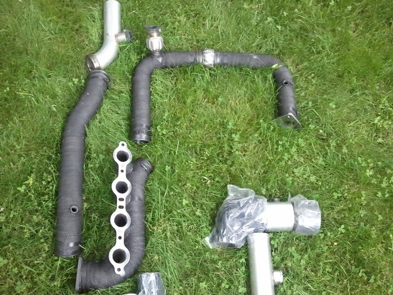

Ok either im blind or im stupid, but I saw you have an 09 1500 4x4 but didnt see what engine you have in it?
And to answer your last question, YES, wrap the log if you can. I ordered my kit with the manifold, down pipe, and crossover prewrapped from Kyle.

I'm wrapping the cross over, dp, and manifold. Takes some time but it's coming out nice.
They say 24 hour cure??? Damnit
When these are baking in the sun I'll start w the gauges, wiring, heater hose, oil pan.
