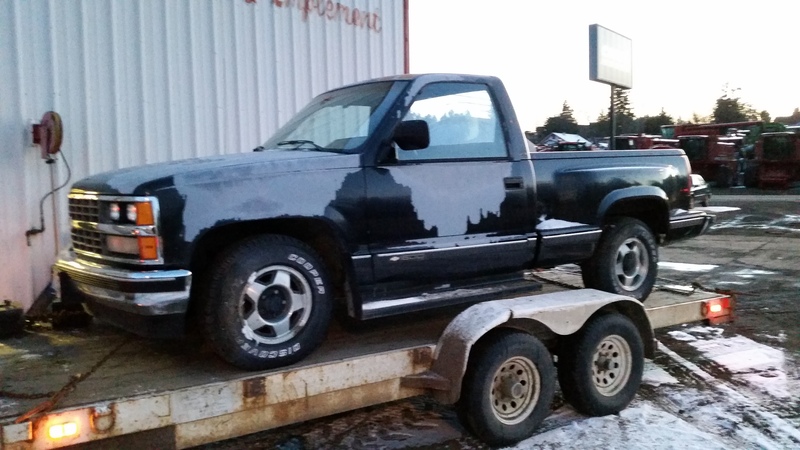

After wrapping my mind around what a spark plug is I decided to make this first project as easy as possible on both my wallet and my mind. I picked up an 88' C1500 step-side shortbox 2wd. 181,000 on the ticker. Figured that would be the easiest platform to stuff an ls motor in.....and it was cheap!
Has a burned up 700r4 and a 5.7.
I already have the motor and transmission pulled. Here's where I'm looking for some advice. This is going to be a toy, something to raise hell with and do awesome burnouts with, but would still like to cruise the streets on occasion.

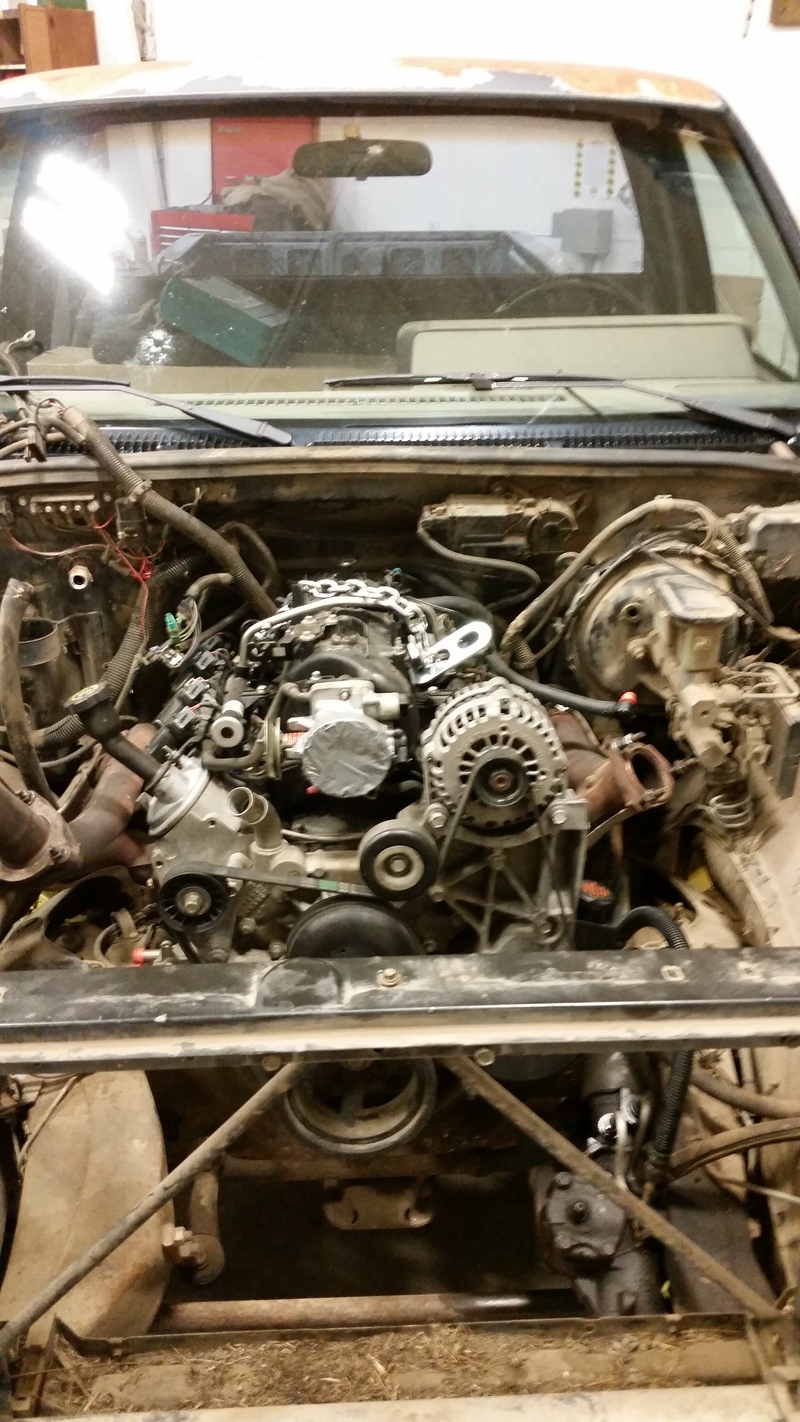

Finally found some time this weekend and made a little progress. I had already installed the valvesprings and trickflow cam, so it was time to throw the motor in.Name:  20150425_095805_zps5uer4v7s.jpg
I used dirty dingo mounts, and the thing basically fell into place.

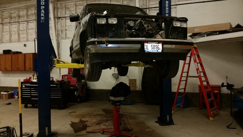

I order a FTI reverse manual valve body TH400 from summit, along with a hughes performance TC 3200 RPM stall
Going in Name:  20150425_111639_zps3pcyjdnf.jpg

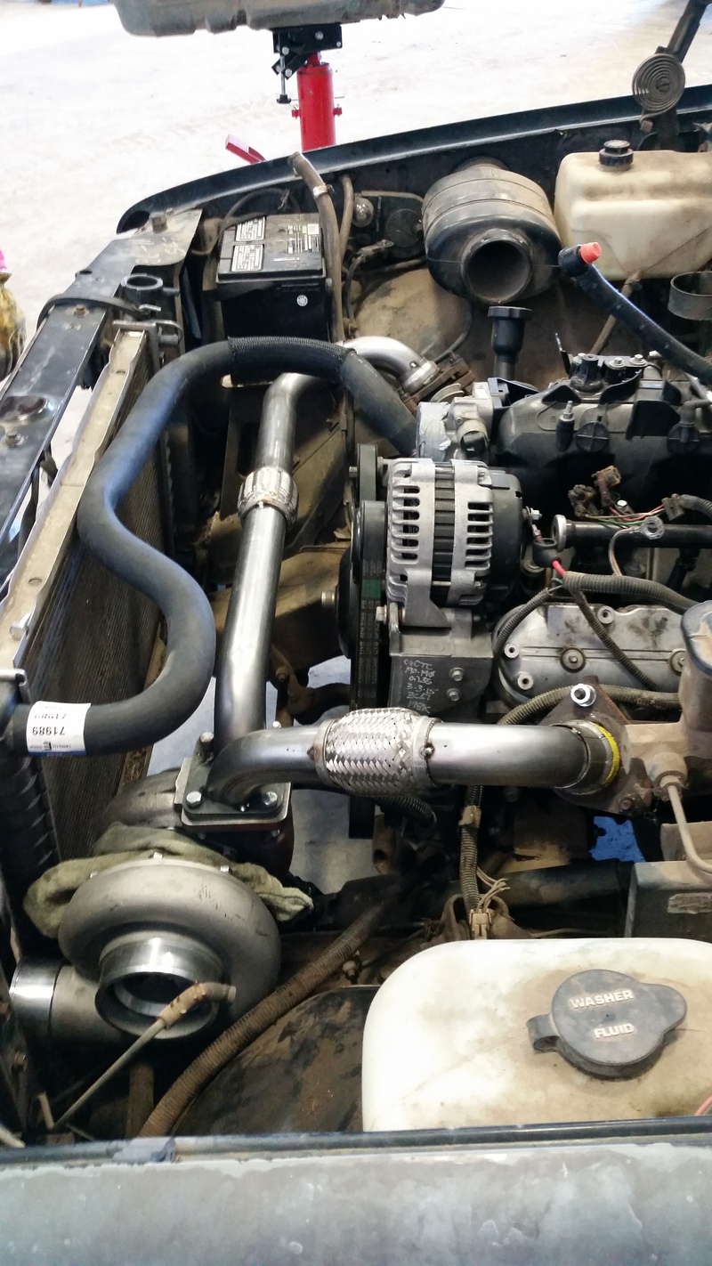

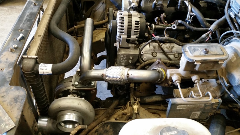

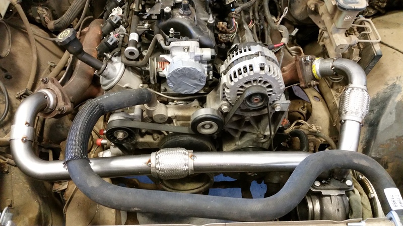

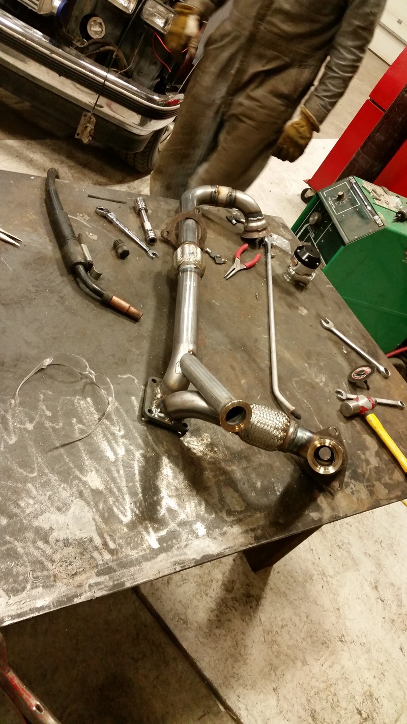

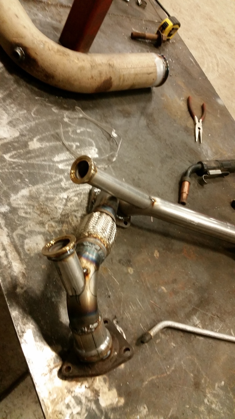

Then jumped right on to building the Hotside.

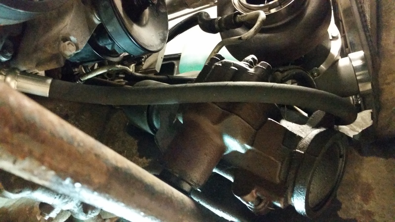

I'm just leaving everything tacked together at this point. I want to mock up the intercooler piping and make sure everything fits before welding it together. I dropped the fuel tank last night and need to install my Walbro 400. Also, the powersteering lines bolted right in place, but they are also in the way of my turbo so i need to move them.
What are you guys doing with the coolant ports that run through the throttle body? Just blocking them off or drilling and tapping the water pump to circulate?
Also, I'm not sure what to do for the vaccum source for the power brakes? Obviously the line is there from the intake, but if I just hook that up will that turn into a giant boost leak when under boost?
On the transmission end of things, I have everything bolted up, but there is a reference line that i think is for line pressure. Can I just block this off or does it need to be vaccume referenced with a check valve to prevent positive pressure?

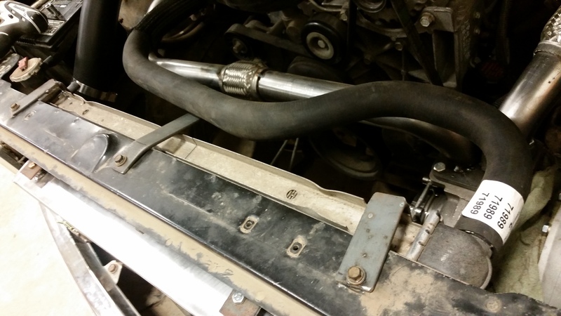

Made some mounts to hold the radiator in

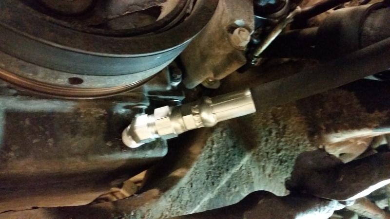

Drilled and tapped the oil pan for the turbo drain. I had a braided stainless line that came in the vsracing kit but it was to short. So i just made it out of hydraulic hose and fittings.
91875[/ATTACH]

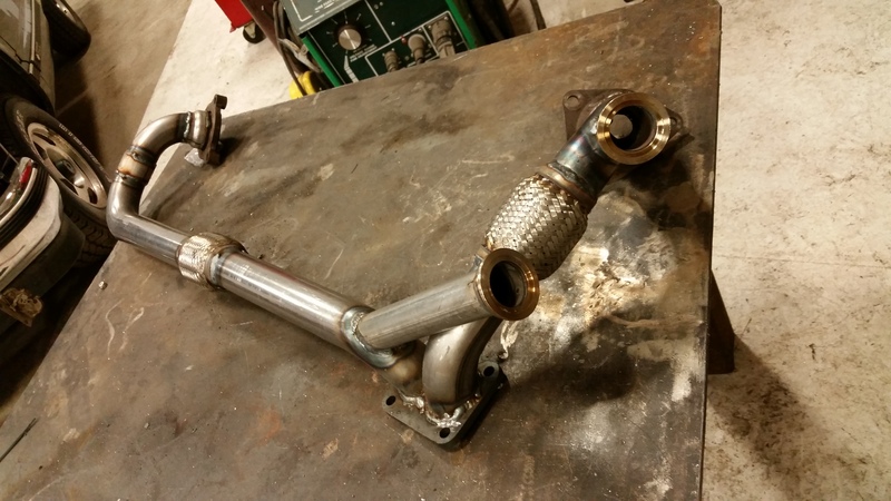

My old man is a welder by trade, so he welded up the hotside for me and then we figured out where to put the wastegates.

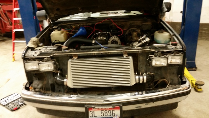

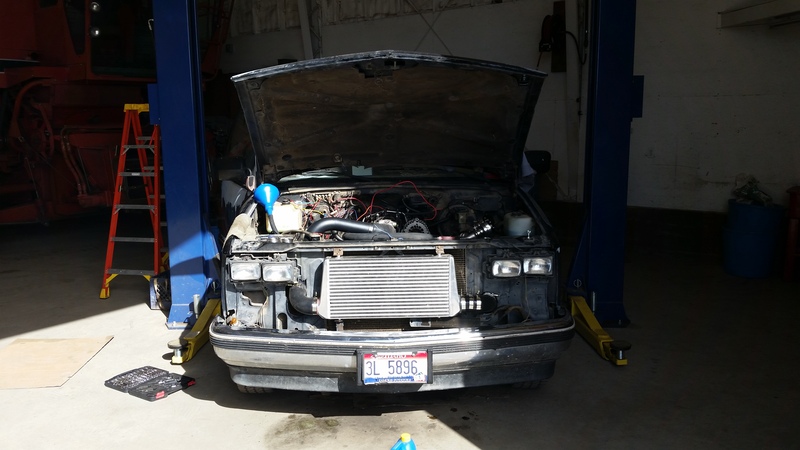

Then I moved on to the intercooler

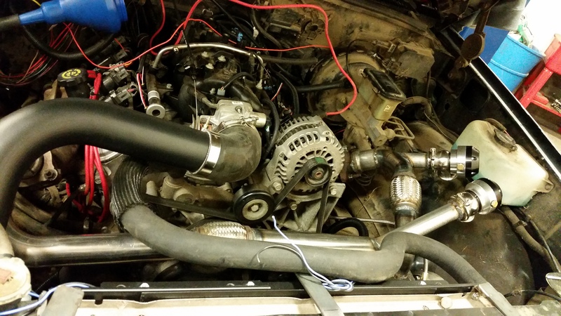

Old Jun 2, 2015 | 10:38 PM
schaef_12's Avatar
Joined: Apr 2015
Posts: 10
So I finally got everything together close enough to where I could start the darn thing. I quickly realized I am in way over my head with the megasquirt lol. So i printed the manual off and have been scouring it trying to decipher what i need to change.
Basically the thing is running way rich at idle. Like 10.1:1 AFR. Plugs are blacker than hell lol. Anyway, was reading up on Tuning the VE table and ensuring all my settings were correct and decided to work on leaning the idle out. As luck would have it, my brand new AEM wideband that worked fine the first time I started it no longer lights ups. Verified power and grounds are good, just simply will not turn on or send info to the MS3 box.
So it runs (kinda) and moves, just need to work on the tune (ALOT). I am getting really anxious to drive this thing and it kills me I can't because I need to learn to tune!

What size is your oil drain line? It seems a little small in the pics.
