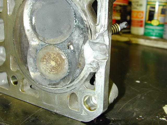

Old Aug 22, 2006 | 07:56 PM
Wilde Racing's Avatar
How do I change this text
iTrader: (26)
Joined: Jan 2005
Posts: 7,294
From: Behind the TIG welder
Originally Posted by Soon2bSpooled
exhaust heat is the best friend a turbo can have...
not when alluminum melts at like 1450 deg......
Keep the iron heads, put the money into a nice boost controler, or toward a good stall torque converter. Keep your eyes open for a KILLER deal on some heads if you must.......... but thats just me...
This is parish8 head, I think he said it went lean and had some detonation, but I wonder if it would have done it if it was a steal head?????
