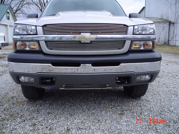

My plan is to put a slim FMIC in the opening of the SS bumper, but not sure what size intercooler would work, if any cutting/trimming would be needed to make it fit, and if whatever fits would be big enough for me. I'm a big fan of the way JKmotorsports tahoe looks(even though it's a heat exchanger rather than an intercooler).
Here are some pics of what I was looking for:

Well what ever FMIC that will fit between your front frame horns will work , that will be your limiting measurement .
Here 's an old pic of the FMIC on my old 04' turbo silvy.

I have a Denali so I can measure that but if you are looking for a SSS bumper then it doesn't do you any good. I only mention that since you have a picture of a Denali front above. I used to have a A2A on my old setup but I forget the measurements. Just measure between your two front bumper supports.
