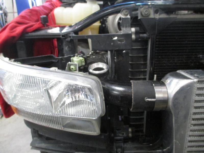

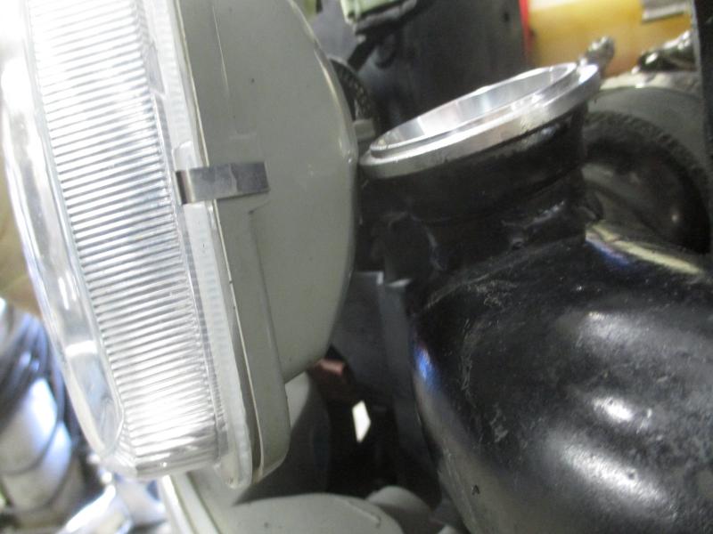

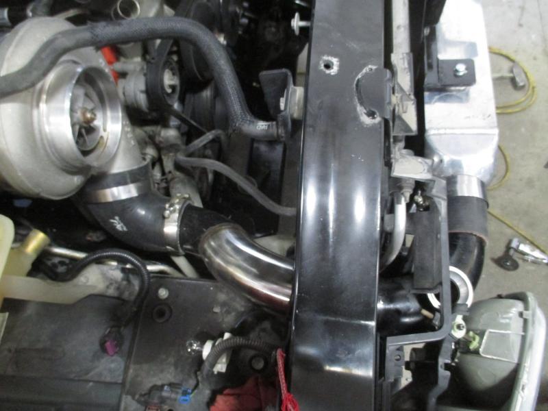

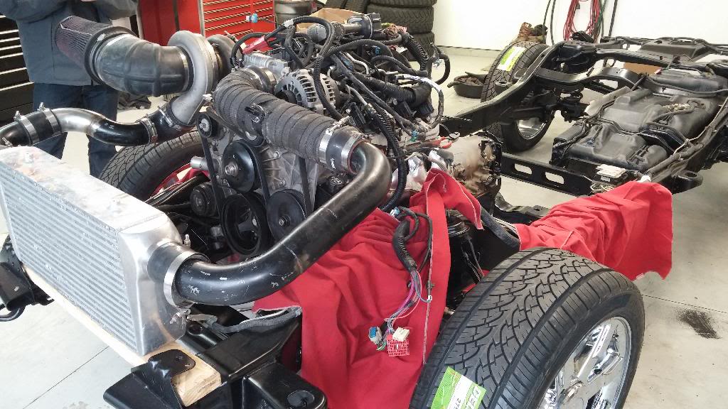

I bought this kit used on this site. I am wondering how you guys make it fit? If would work if the BOV was not on the elbow. See pictures
Do I need a new elbow and move the BOV?

Why would you put the bov preintercooler?
Old Oct 5, 2014 | 10:13 PM
Iconic Motorsports
Joined: Mar 2004
Posts: 368
From: S. Florida
i wanna say that pipe goes on the other end of the intercooler before tb.
Old Oct 5, 2014 | 10:19 PM
LS1TRUCKGUY's Avatar
Joined: Nov 2005
Posts: 2,452
From: Deer Park Texas
That elbow looks like it goes to the throttlebody. The bov is usually between the intercooler and throttlebody

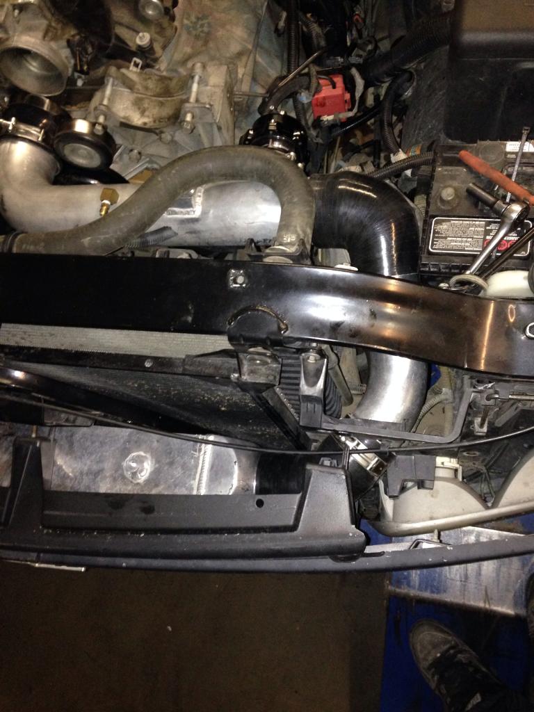

I dont see it working without modification/

Can you change your title?
That is not my ic layout for that year model truck. .
Nor my my kit for your year model truck.

I was gonna say... That ic piping doesn't look like anything Rick would turn out. Looks to me like someone bought Trick's hotpipe setup and built their own coldside.

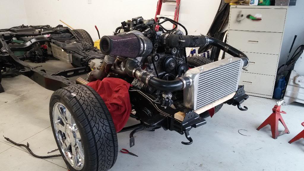

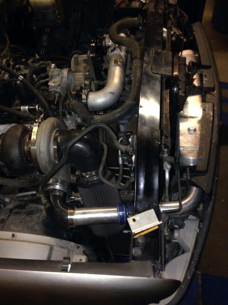

Yeah, the Trick kits are laid out different. Here is my 07+ kit on my 2001 before a little modification (removal of the maf pad thing-a-ma-jig)
-Kenny

Look like you could flip the sides and it might work. Have the person you bought it from to send you some pics if how they has it installed on the vehicle.
