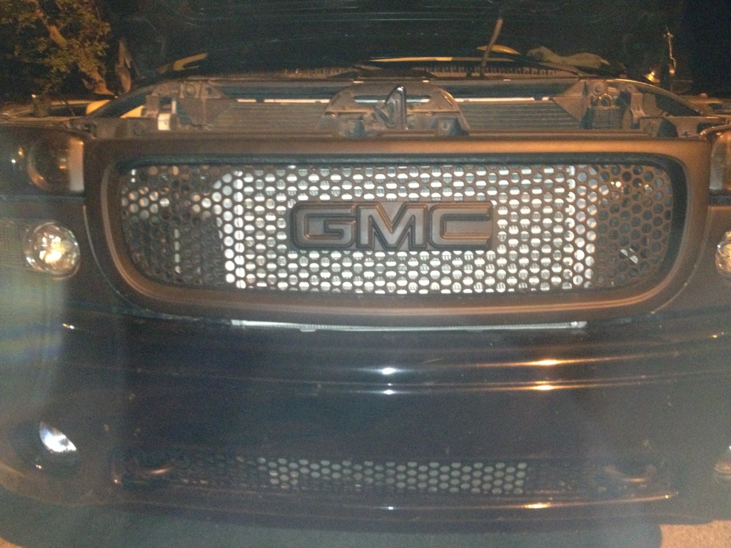

I'm not turbo but I run a cxracing 31x12x3 behind the grill on my 01 procharged sierra

How much boost and where Dodd you mount your trans coolers

for mine if you look in the bumper you can see the trans cooler. so far Ive seen 13psi.
