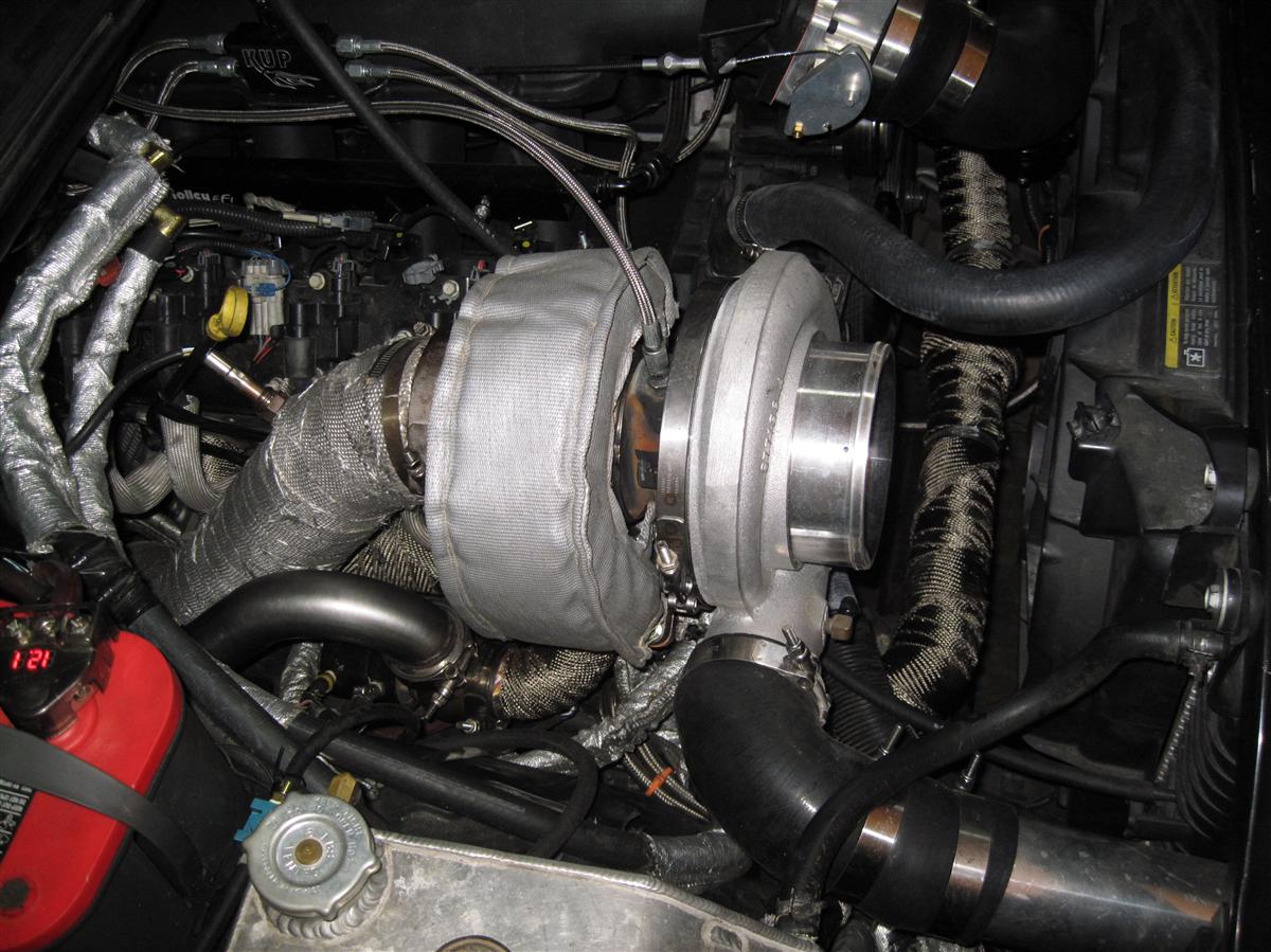

Yea, and ive already trimmed my fan shroud back to the actual fan, so there is no more room possible without moving the turbo back...

I know its the piping and not the filter, I pointed that out earlier. And 1100rwhp is not twice as much as I make

i just asked him and he said throw a filter on the turbo without the piping. it will give you the best possible flow with little raise in intake temp, but after the intercooler and meth you will be plenty cold.

Yea, and if it were possible I would, but look at the picture above. No room for a decent filter going straight out. Only about 6.5" from the base of the turbo inlet to the fans.

might have to get custom, try slight angle. you can weld to the turbo housing if needed

I did get custom, see the first post
If the pipe is large enough not to cause a restriction (which hopefully my sewer pipe is) then it will behave the same as the filter directly on the turbo.
