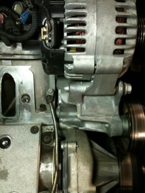

Also, if you haven't, you will need to notch the alternator bracket like in this pic, or you will break off the oil pressure sending unit trying to put the blower on and it still won't fit, ask me how I know, And you can not change the oil pressure sender with out pulling the blower and the valley cover off.

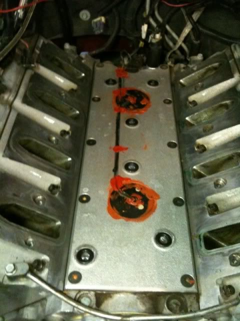

Another thing, make sure you get the knock sensor wires in the grove and use some silicon to help hold them there. If they don't stay, the blower will smash them and short them out, again, ask me how I know,
