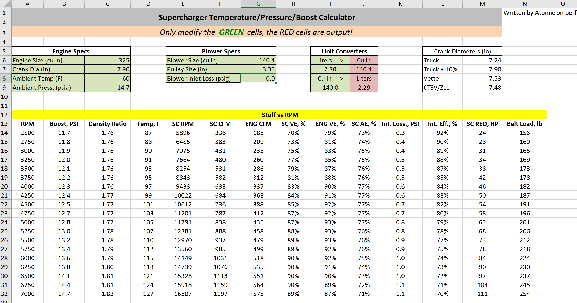

With a 5.3, 2.3L blower, OD crank pulley, you need a 3.3-3.4 pulley to make about 12-13psi.

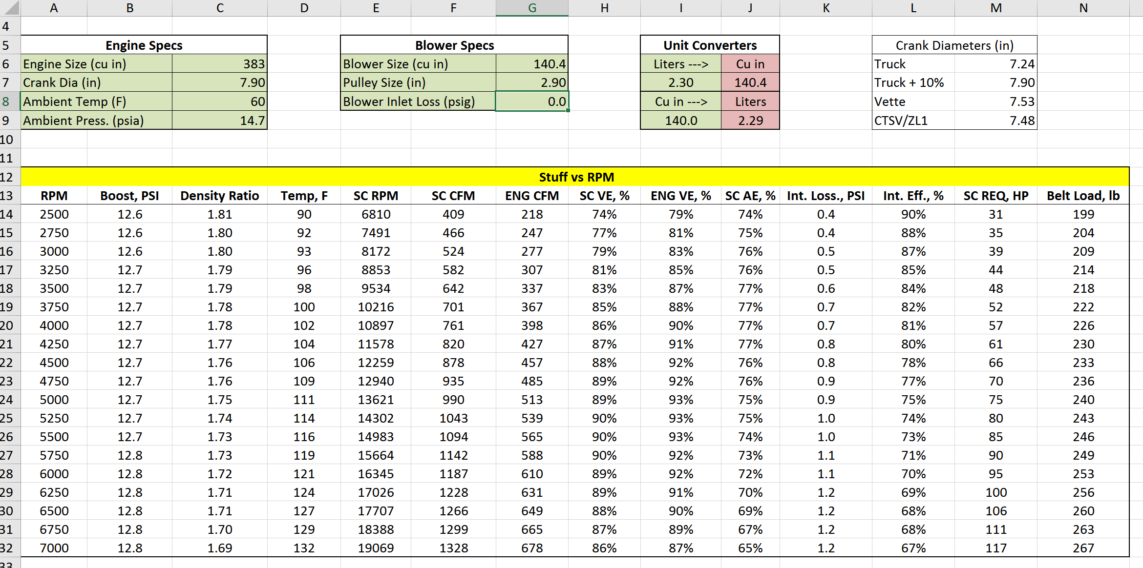

very nice. sounds good. this is going on a 383 stroker with trick flow heads and 228/232 cam

Ah, looks like about a 2.9 pulley then

Belt with a 2.9" is a K081088
That's with 90mm idlers.
****, I forgot I have a 5/8" phenolic spacer. That throws a quirk in.
