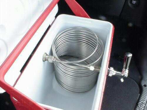

Looks like my "coil cooler" for kegs of beer...that may be an awesome temporary (track night) solution...have a coil cooler (like this one) and add it into the intercooler loop...and don't forget to add salt to the ice water, I know we aren't making ice cream, but it will get a lot colder!

Switch it from I/C to keg between rounds!

I have a large vortech cooler box also. It works great at the track to fill with ice. It takes longer for the fluid to heat up, but it also takes longer for it to cool down. I've got a drain on the box and one on the intercooler core. Checking water temps after highway driving in summer, the water temps in the box were mid 90s.
I also added an on/off switch under the dash for the intercooler coolant pump. That lets me fill with ice, and keep it off while waiting in the staging lanes. Then when I'm a couple of minutes from running, I'll switch it on.

um, pics please!
