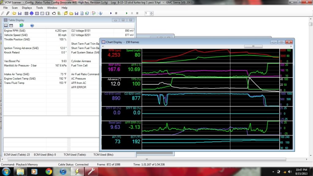

Got her turned up a bit. She floats around 6.5psi to 7.5psi. Feels like a whole new truck. Although, the spikes persist. Just trying to get a safe tune on my truck if you don't care to take a look. Here a screen shot, and I'll also post a log and config. Still running pig rich.
