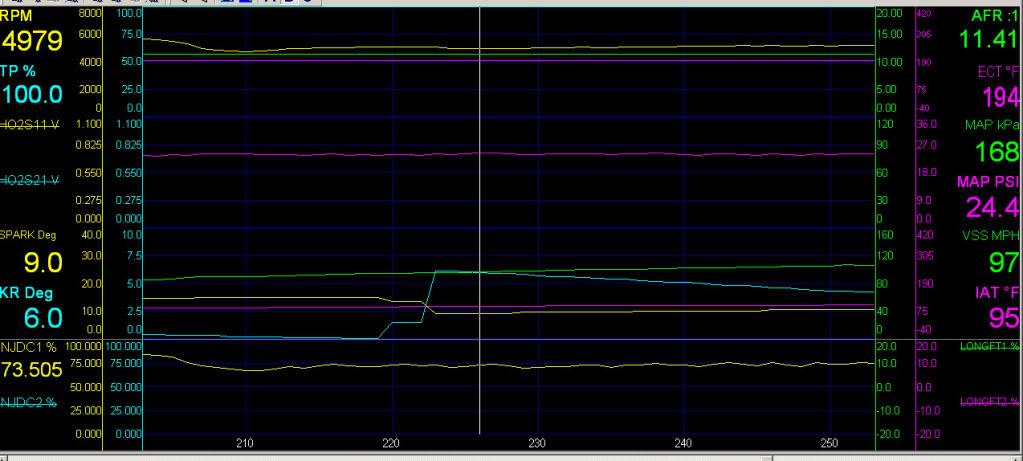

Stock48 - I know this is going back a while, but did you ever figure out was was causing the knock retard. I'm seeing the same issue with mine, its pulling 6-8 degrees of time on me at WOT?

How much timing you running? got a log or scan of it?

timing was at 15 deg, then pull 6 degree under WOT. Have a look any suggestions?
