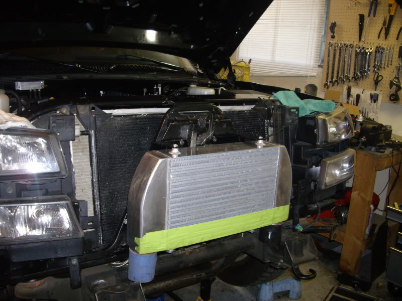

I have a 29.5K cooler in between the condenser and intercooler. Fits perfect in the A frame.

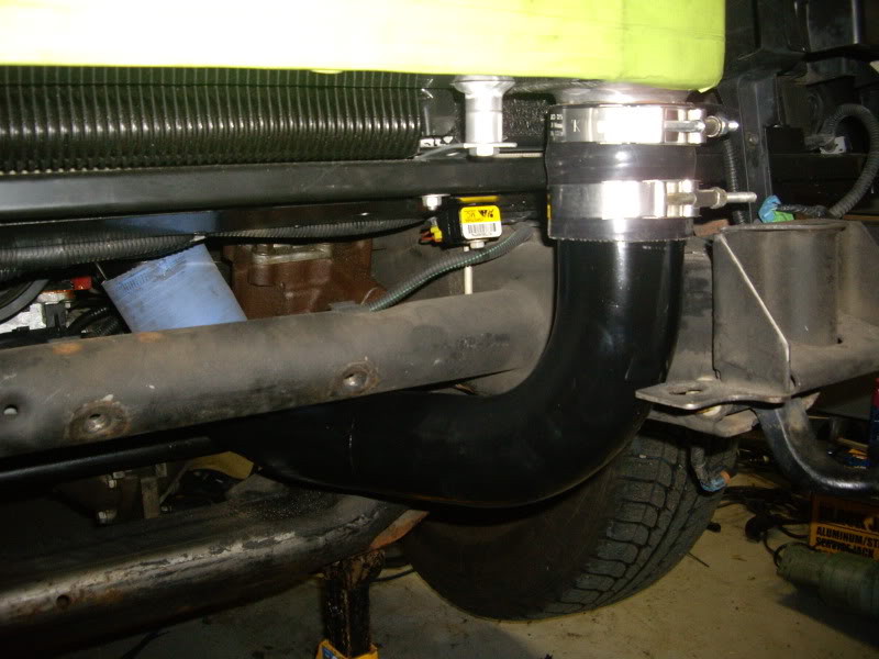

Thought I had pictures of mine in this thread but I guess not. You can see the trans cooler behind the intercooler.

Thats pretty slick, I like that.

That's a good way to route them, how do you have it routed to the tubo though?

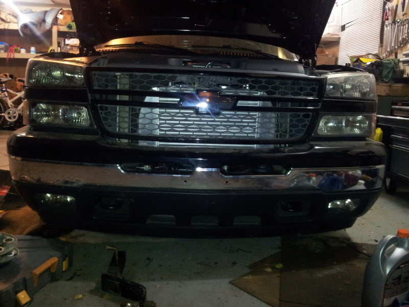

Here is mine, Procharger 1300hp intercooler.

Black04, thanks for the pics. That's exactly how I am planning on running my setup.

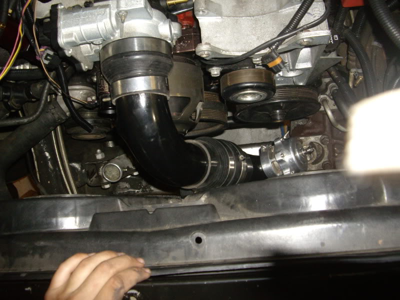

Turbo points down and then I have a 45* that goes around the idler bracket then another 45 down and a U into the intercooler.
