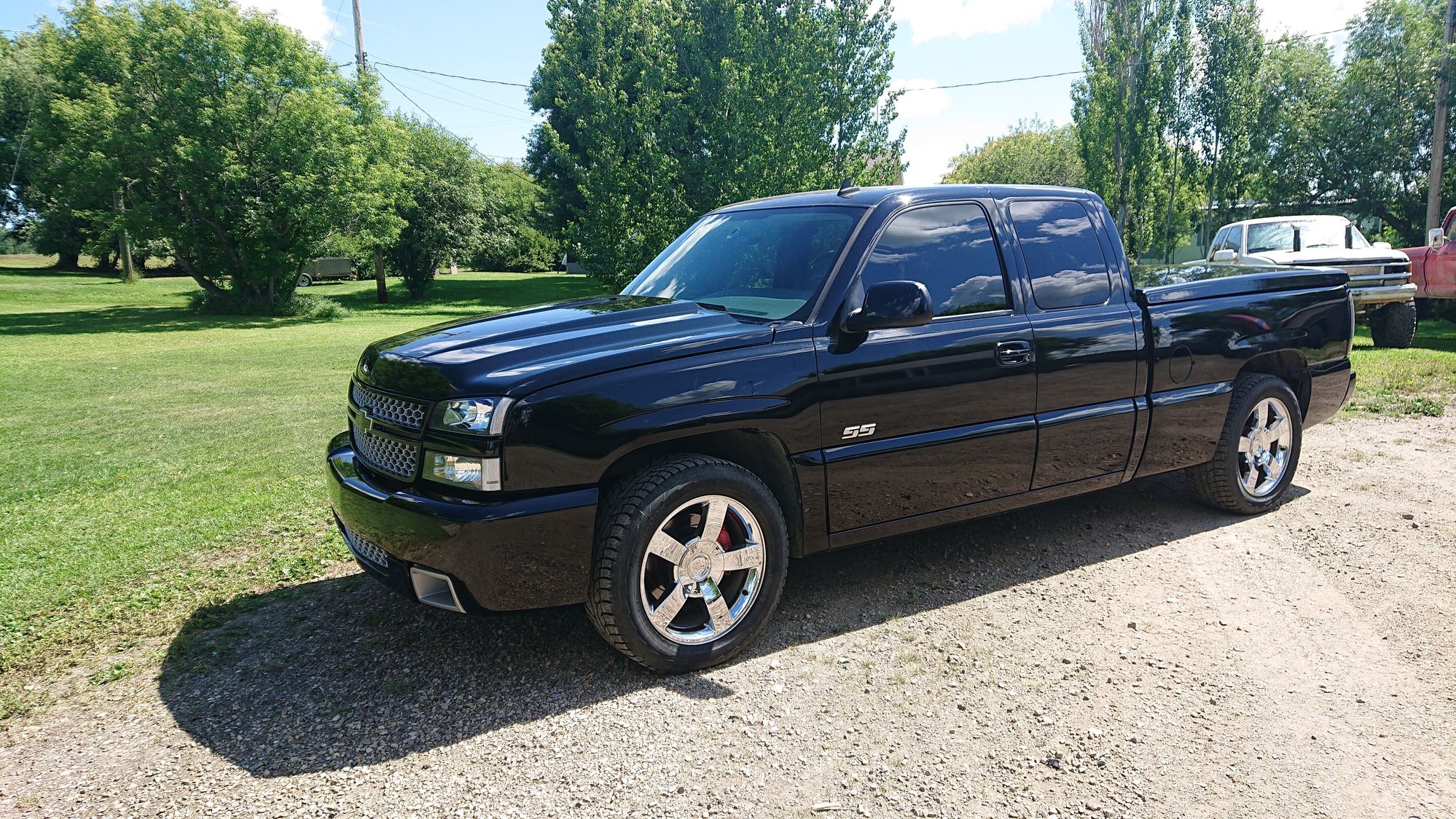

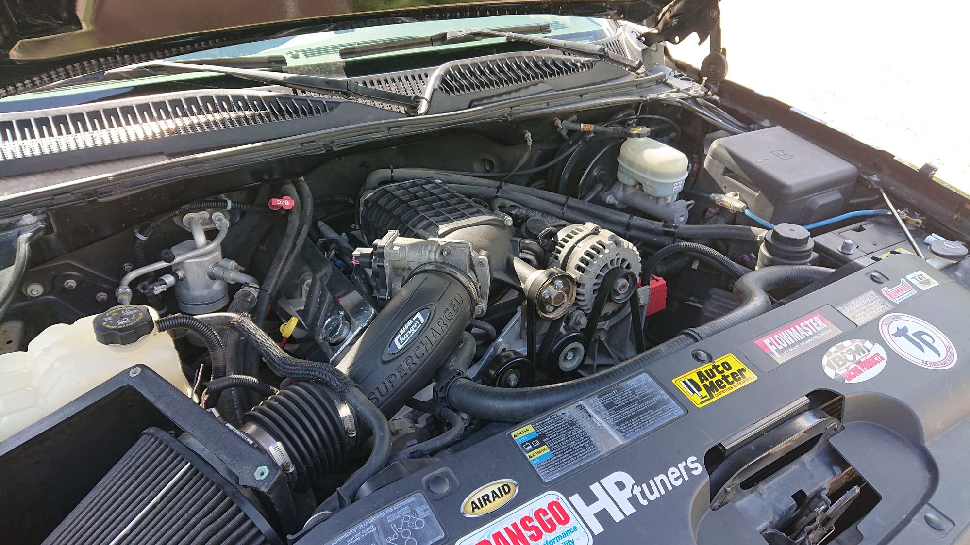

I know it seems childish but could anyone give me a rough estimate of my hp at the crank? Im at least 4 hours from a dyno or track, so that's not something I'm interested in or plan on doing. 2006 Silverado ss, 6.0 lq9, Radix with 3.0 pulley (7.5 psi max), afe cold air intake, FIC 80lb injectors, American racing long tubes, high flow cats, cutouts/ flowmaster 40s, Msd wires, Tick stage 1 blower cam 223/235 | .615"/.605" | LSA116+5, tuned remotely by Nelson performance via HPTuners

I figured 325 stock, (?) add 100 headers and cam, and add 50% with 7.5 psi. That is 637.5. Then I subtracted an arbitrary amount for the blower's inefficiency.

I'm with Mike. I would guess mid-high 500s easy. Those blowers are pretty efficient on a low boost setup.

Your easily making 550 with 7lbs of boost.
