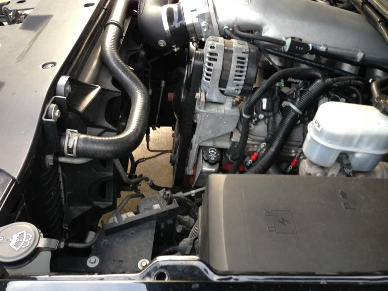

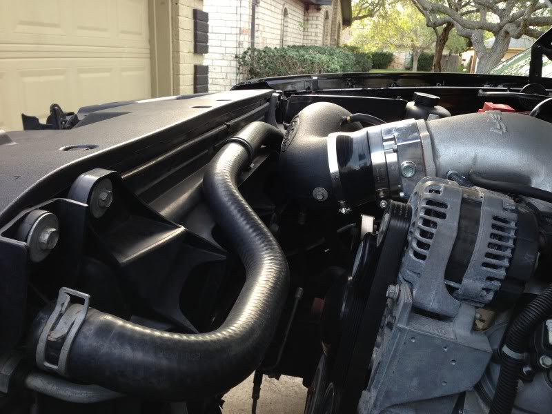

Just drill and tap and put a nipple into the hi ram and run a hose from the purge solenoid to the intake. That's what I did.
Old Oct 21, 2013 | 06:06 PM
  #26
Three6GMC's Avatar
Joined: Mar 2010
Posts: 2,165
Likes: 27
From: Corpus Christi
This will give you a better idea of how it fits... Also you can see where I tapped and plugged into for the fuel pure solenoid and pcv. These pics were taken before I used better hose and ran the solenoid and pcv under the intake so don't mind how ugly they look lol.

Three, is that the mid ram or the hi ram?
Old Oct 21, 2013 | 10:29 PM
  #29
black00chev's Avatar
Slowest turbo build ever!
Joined: Dec 2009
Posts: 2,905
From: Warrenton, VA
That's the hi ram
Old Oct 22, 2013 | 04:00 AM
  #30
Pro52R's Avatar
Joined: Nov 2006
Posts: 785
From: Jax, FLA
Any more pics of that setup, Three 6?
