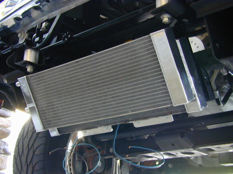

Forgot where I found these pictures but I saved them to my computer as a good idea.....Is this the #1 consensus?
Attached Thumbnails High iat?-intercoolerfans.jpg   High iat?-intercoolermount.jpg

then again the TBSS has the biggest intercooler they make. Tahoe upgrade to teh tvs i run 12-15 above ambient and after 3 full runs back to back (and chewed up belt)115 max iats and drops to 15 above ambient within 1 minute. I know with the 112 i had to drive around longer before it dropped down but with the canton tank in and the watter wetter from Redline it drops down much faster than before the tank thats for sure.

The larger reservoir doesn't do much for street use. When in traffic or slow speeds, it stores up more heat and takes longer for the heat exchanger to drop the coolant temps. At the track though, you can load it down with chilled water.
