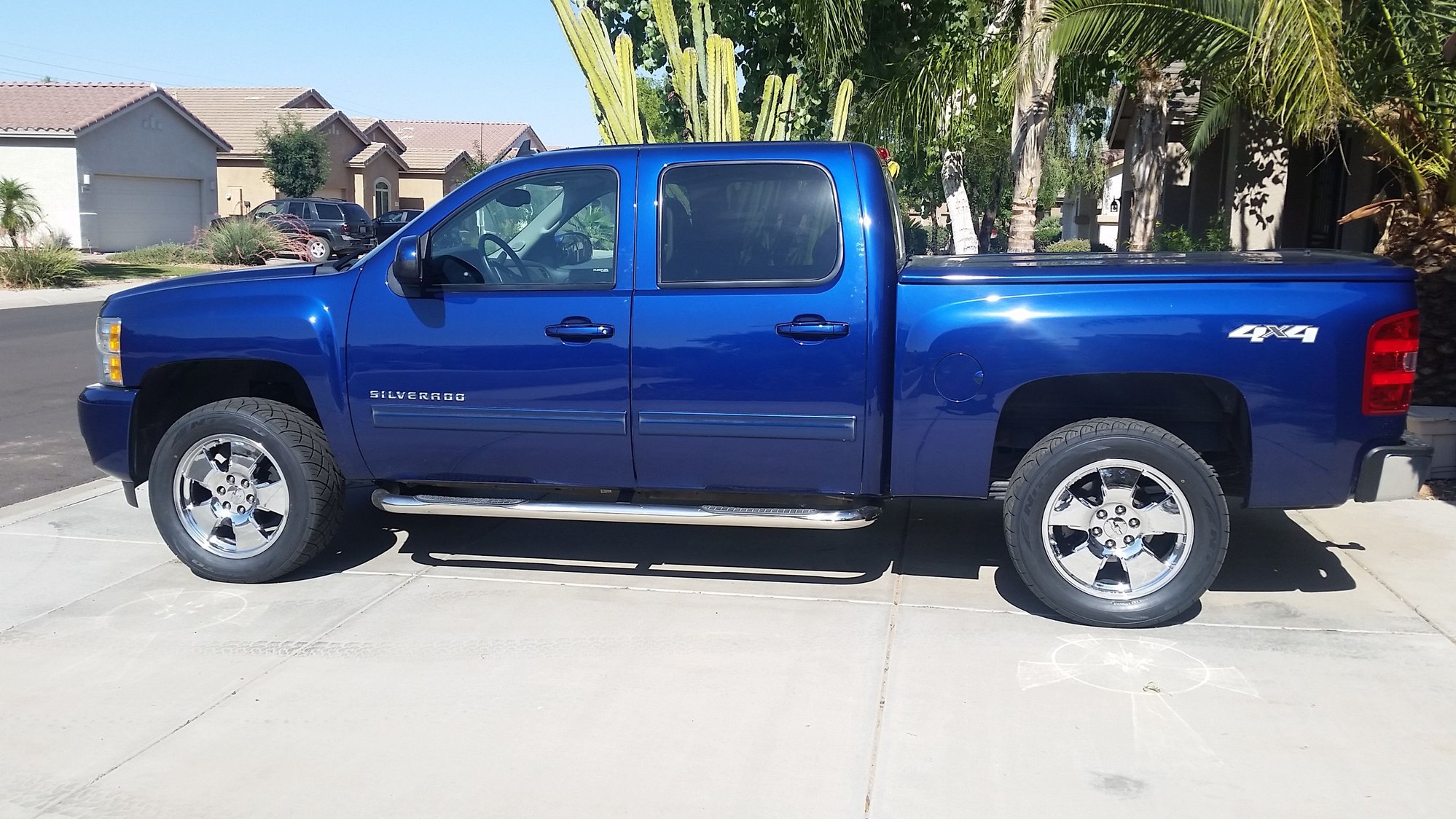

New 20's with Nitto 420s 305/50r20's
OK, here it is with the new 20 inch rims and that Nitto 420s's @ 305/50r20. These should give me a little better grab on the pavement ( though if I reach the 500rwhp/650 crank I'm shooting for nothings going to grab very well ).

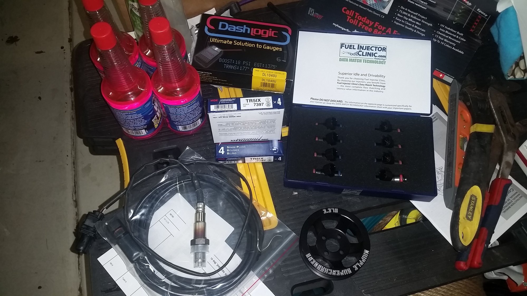

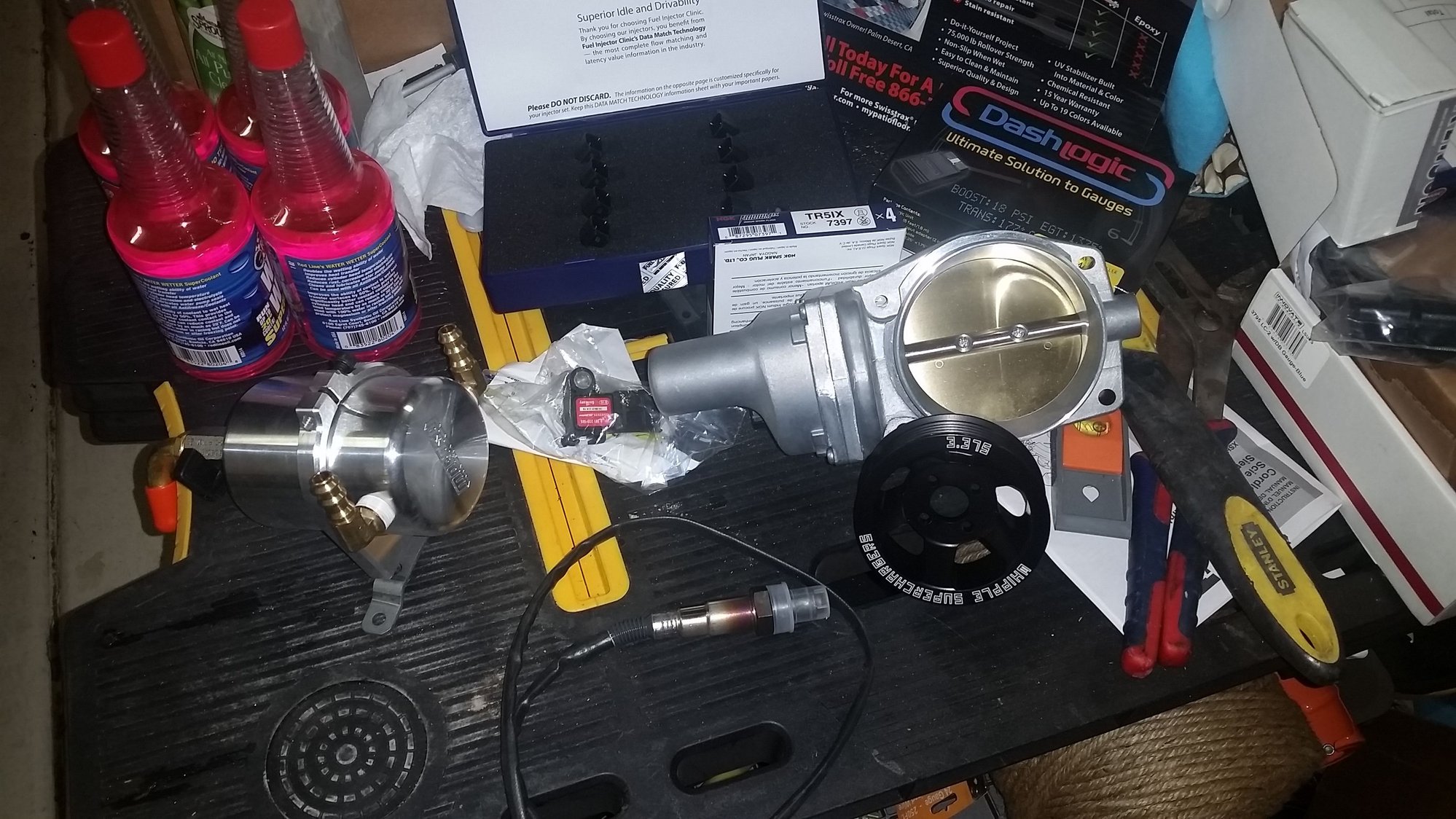

Wide band, Dashlogic, Spark Plugs, Injectors and 8psi pulley.
Catch can, TB and MAP sensor plus the extras
Have everything in but the actual super charger. Got the extra pulley already, but not the SC itself. The caltrac's are still in a box, but have them in the garage too.

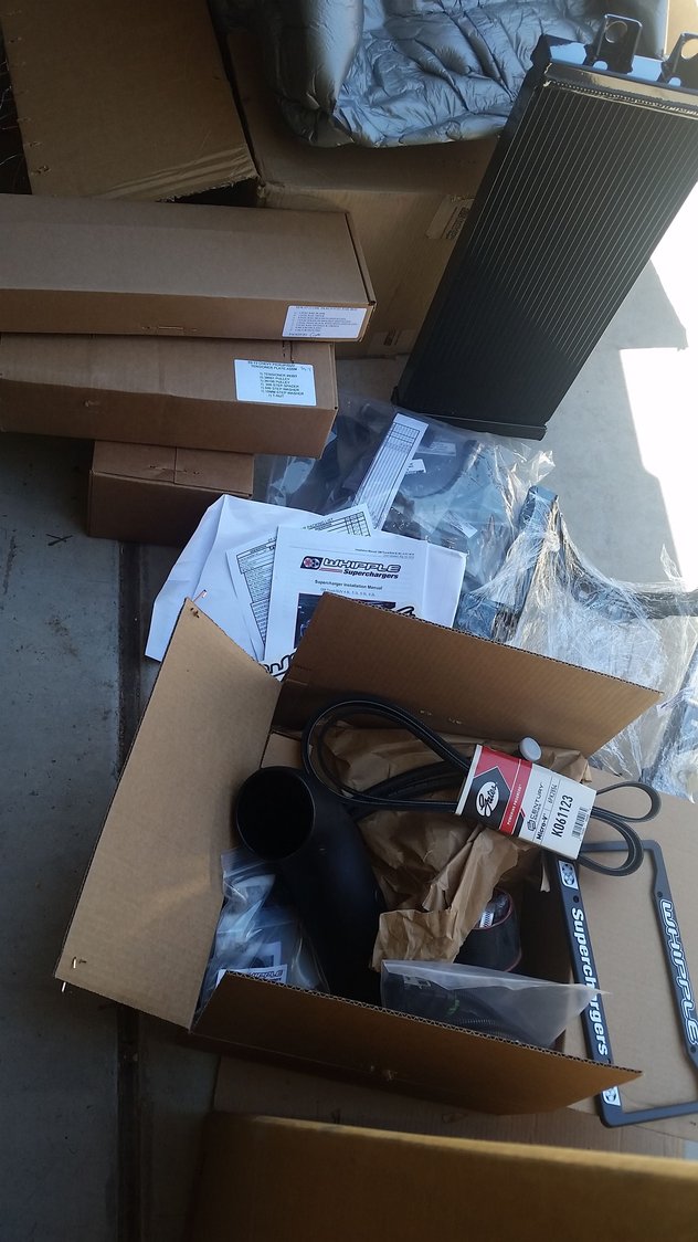

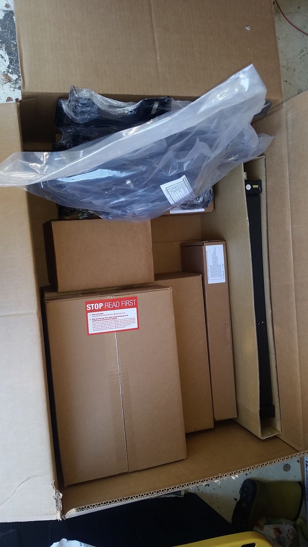

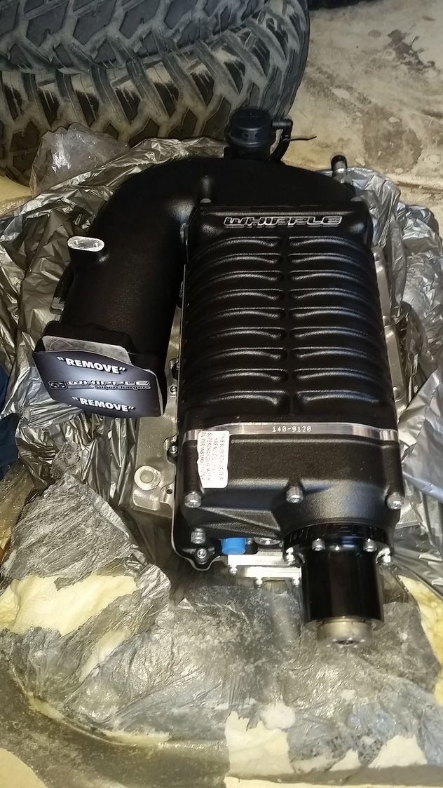

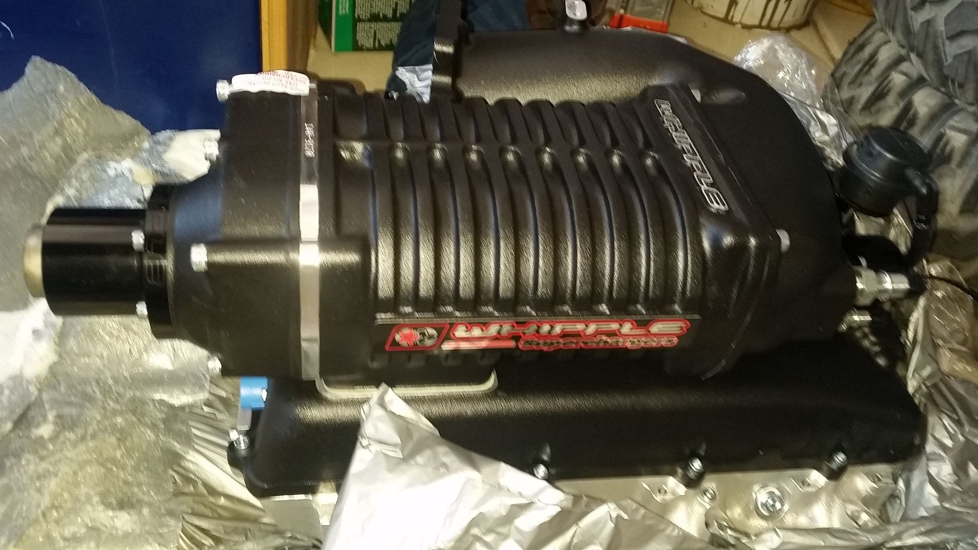

Well, looks like Santa showed up in time for Fathers day....... Will be over a week before I can get time to install, so next week I will get the last things done that I need, get the Wide band bung welded in, and get all the prework done i can, like putting the injectors, map sensor and TB on the Whipple. Will have the tuner setup for the Monday right after..so.. all things go good I will be driving a rather nicely powered truck come the 27th.

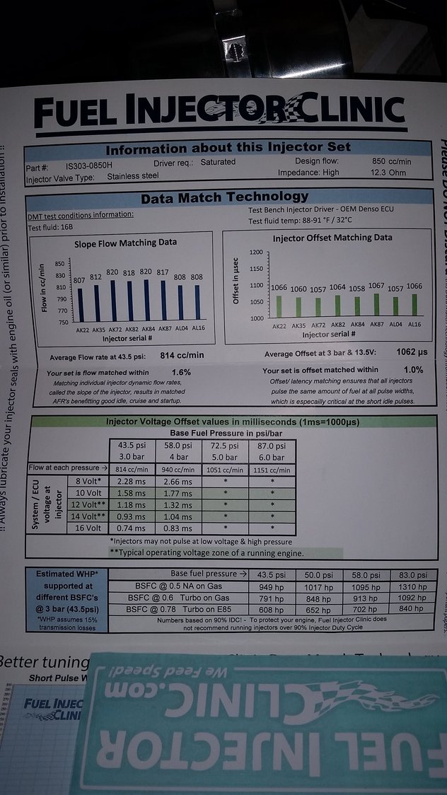

nice matched set of injectors
Probably my wheels while the truck is at the tuners.
Pieces and parts i the box
Whipple 2.3l Front view
Whipple 2.3l Side view
Whipple 2.3l Back view
Pieces and parts
