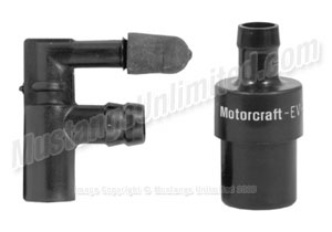

getting blow by and need to throw a check valve on the left side where are you guys getting them from and do have pn's

left side?
driver or passenger side... ?
year of truck? motor? boosted?
we need more info.

sorry driverside look in the sig its a 5.3 at 6psi

Motorcraft EV127A
this is what i picked up for my build, got it off amazon for $6

hmm got any pics of them installed

Plug the intake and vent both valve covers if that don't work.
If that doesn't work ...

the piece i posted on the right will fit in the stock pcv valve location, vent the passenger valve cover and plug the TB on the left side
