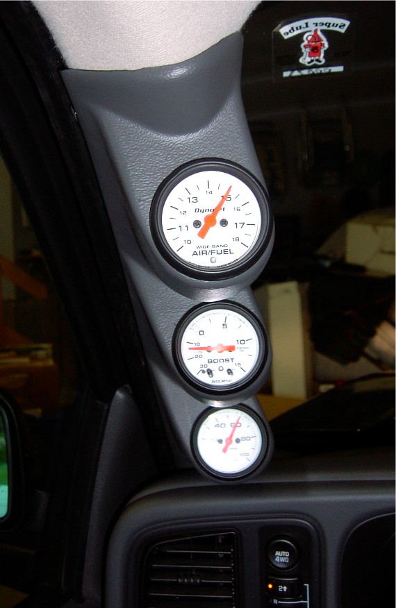

I think that the overhead is kind of awkward to watch while driving. The pillar is closer to your line of sight. Something that mounts on top of the dash over the steering wheel would be better though. I had my gauges sitting on top of the dash while I was waiting for the correct pillar pod to arrive. I noticed that they were very easy to follow without having to look away from the road and refocus. Could be my middle age eyes though.
My most important gauge is the wideband AFR. But I have added several mods and been doing some tuning. My eyes are glued to that gauge after making any changes. The others provide useful diagnostic information if anything does go wrong.
