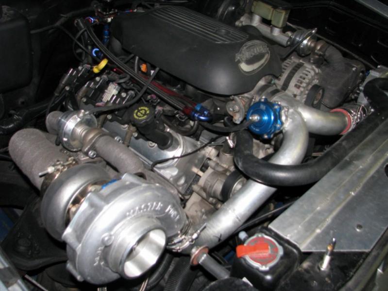

I welded some aluminum angle on some FAST rails and bolted them on.
They work great and flow more than any stock tube fuel system will.
They were easy to make too.
A good flowing fuel system is needed if you plan on making lots of power.
This setup here will support 1000hp.
Here's a pic of them mounted, that's the best one I have.

I have after market had to make my own brackets and i wouldnt trust the stock rail for anything with serious horsepower IMO. BTW i have over 3k in the fuel system these An fitting and what not are very pricey
i like your set up..i see the return out of the bottom of the FPR and i see the lines off each side going to the new fuel rails. but i see two new black lines coming from the back of the motor i know that one is from the pumps i think.. what is it for and were do they go.
NM i guess you Y off to feed one to each fuel rail and then it goes returns to the FPR and then to back to the tank. right??
thanks for all the pic and help
