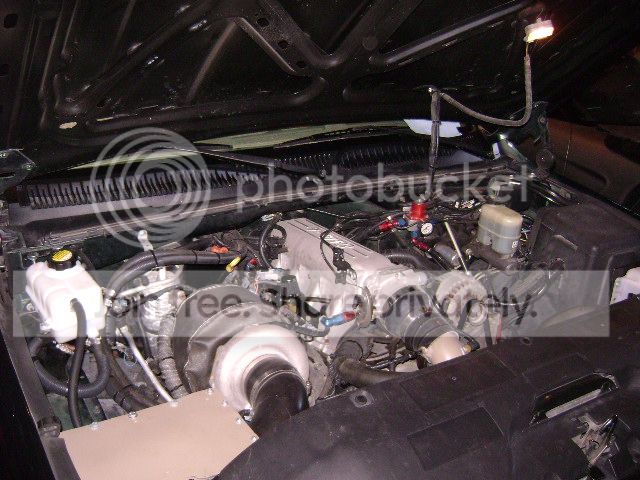

Kbracing kit. On 15lbs it made 662rwhp. On 19lbs it makes 713rwhp through a 4l80e and 14 bolt. You can search for "haba verde" for my truck build up.

Yeah .96 ex housing, standard PT88. Get a 4l80e with a slip yoke, the bolt on yoke will be nothing but problems.
