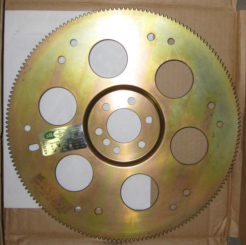

Started out with a TCI. but now run a Meziere billet, 1 piece plate.
Why did you switch from the TCI? The billet piece saves roughly 1.25 lbs versus the Steel piece. Otherwise I can't come up with any other reason for the extra $100+ on the billet.
