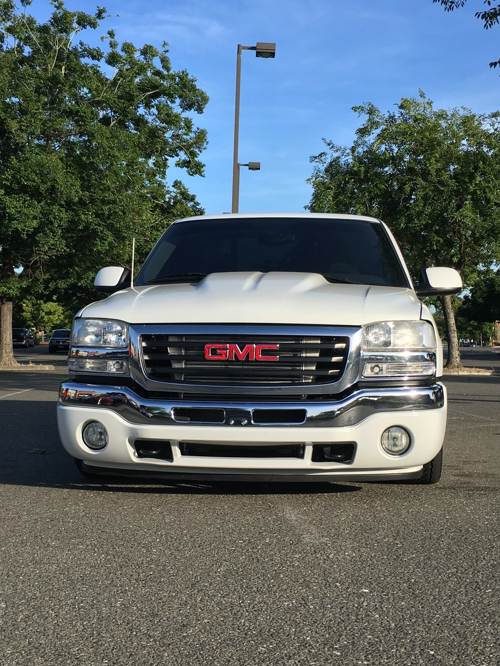

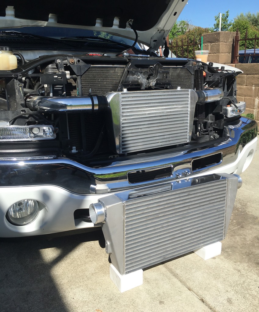

New intercooler in, made a huge difference in IAT's. I made a few WOT runs yesterday. Was about 84* yesterday, ran it through 2nd, and 1/2 way through 3rd, and IATs didn't go above 96*. Just as a comparison, I did the same with the cx intercooler, on a 56* morning, and the IATs jumped to well over 100* and the ambient temps were way lower obviously.
The TR1235 Treadstone cooler fits great behind the grill. The A frame is still intact behind it. Just had to cut a few inches of off the old piping and make some L brackets to bolt to the frame below. Only complaint is I wish the endtanks were polished.
