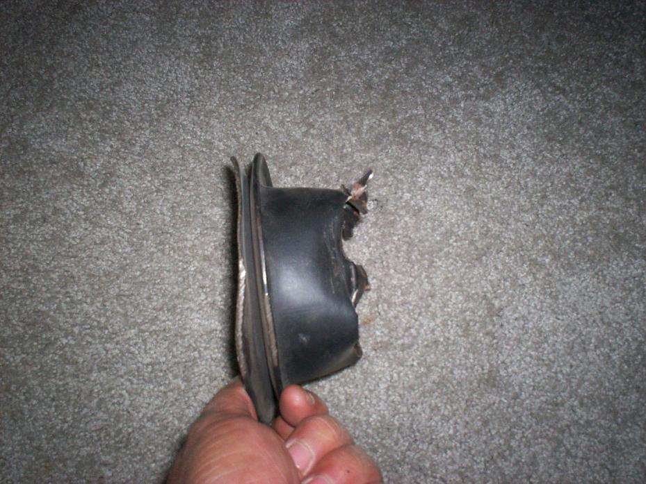

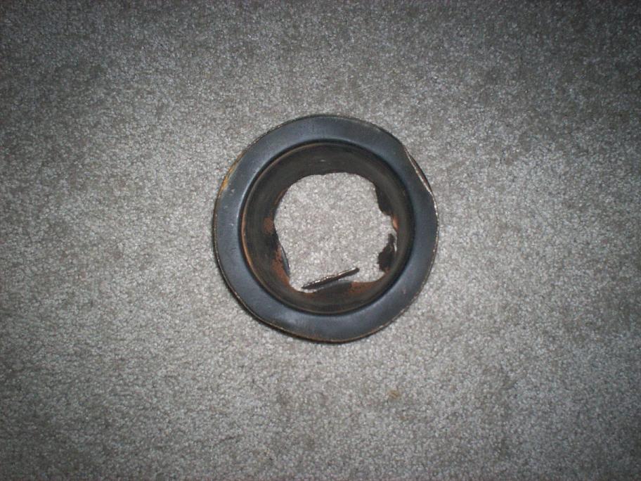

3 bolt's on the crank pulley? Could end up like this one did.

ok I will bite.... Hemi what the hell was that carnage from. looks to be a old V-belt setup.
Yup, your correct. It came apart after a 9.8x pass@138 mph. That steel drive pulley only spun an altenator, not a blower. The engine was a 605 cubed Hemi making 805hp/800ft lbs, tq. An F1A series blower is capable of making up to a 1000 hp at the same rpm as the 605. My concern is how much that Procharger aluminum crank pulley can handle only using 3 bolts. We have a few, off the wall Procharger builds going on at this time and none use less than 6 bolts on the drive pulley. Just my .02
